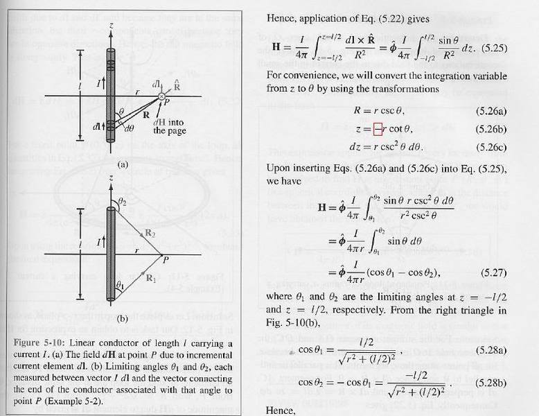

Anyone can tell me why there is a -ve for the z= -r cot theta for the picture shown below? thanks!
Because z is negative with respect to the horizontal line passing through the linear conductor which I take to be z=0.
