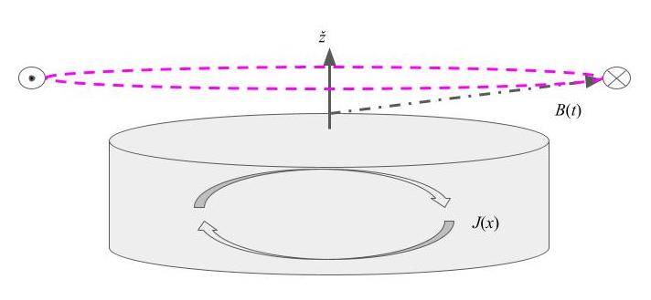

Hello all,
what would happen to a perfectly conducting cylinder immersed in a rotating magnetic field, with the rotation axis parallel to that of the cylinder? I guess the cylinder would start to rotate with the field? Right?

The cylinder is perfectly conducting. Why should the cylinder move when the electrons can re-arrange themselves freely? I haven't solved it analytically, but my sense is that the magnetic field will exert a force on the electrons but the electrons will not exert a force on the conducting cylinder. In other words, the magnetization of the cylinder will rotate with the magnetic field but the cylinder itself will not rotate.

Do you have a visual? If the magnetic field is the same strength all around the cylinder and the cylinder is solid what Twigg said is true. One of Maxwell's equations states this.
Independently of whether the field is uniform or not, Maxwell's laws actually state that there should be an electric field associated with the time dependent part of the magnetic field, which would tend to produce a current distribution in the cylinder with a profile according to the figure below, and under "reasonable" conditions forming a sort of vortex about 90 degrees out of phase with the magnetic field.
You may find that this induced current and its associated Lorentz force influence the steady state behavior of the system (at least when ##R_{cyl}\omega B_\perp## is "reasonably" large.)

No rotation.
Consider the equivalent situation: constant B field in the x direction and the cylinder rotating about the z axis:
## \bf B = B_0 ~ \bf i ##
A free electron would have velocity
## \bf v = v_0 cos(\omega t)~ \bf i + v_0 sin(\omega t)~ \bf j ##
Then the force on a free electron in the cylinder would be
## \bf F = q_e~ \bf v \times \bf B
= -q_e~v_0 sin(\omega t) ~B_0~ \bf k ##
i.e. along cylinder major axis.
