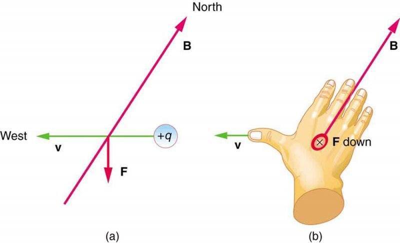

Should the diagram for question a) be like this?

The wire crossing the field west would be a positive charge if I'm not mistaken?
The force is directed down.
The field is directed North.
So I think this is right, just I'm unsure of myself because this is new...

Diagram (a) is correct for a positive charge moving west through a magnetic field pointing north.
A westward conventional current will have a resultant downwards force.

By right hand rule if my fingers are facing the field and thumb facing the charge, my palm is facing the plane so the force is still directed down...

No heaven forbid you spoil it! ... o_O We're all good, it wasn't asking to place numbers in it thank god, because if it did the person marking it would have known I didn't understand the distinction between radians and regular angles... Hence I got a good grade. This brings me to another point.
In degrees... 4,6 m would be the length of the wire if L = 4/sin(60°) in deg... I don't understand why it is ½√3 in radians, because 60° = π/3... No? This is the edge of my understanding of radians, or lack of it.
If L = 4/sin(½√3) = 5.25 m, F = 1.4 2 (4/sin(½√3) sin(½√3) = 30.82 N (down)
I thought F = i B (w/sin θ) sin θ =1.4⋅2⋅(4/sin(π/3)) ⋅ sin (π/3) = 11.2 N (down)
So I'm confused... want to spoil this?
