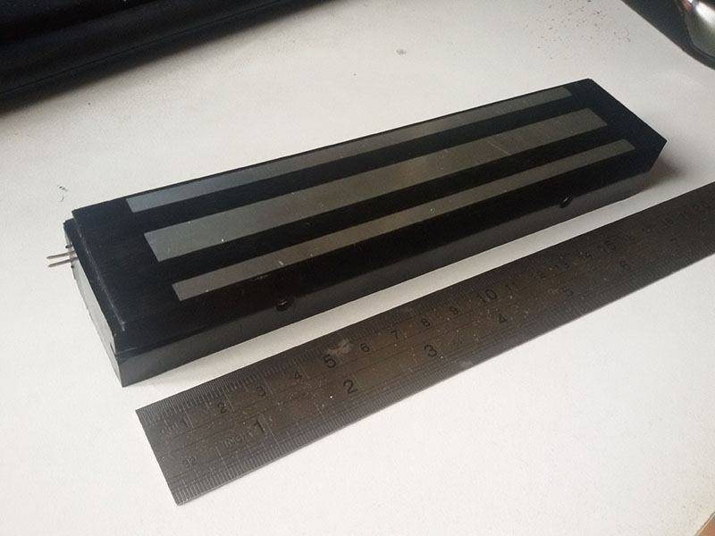

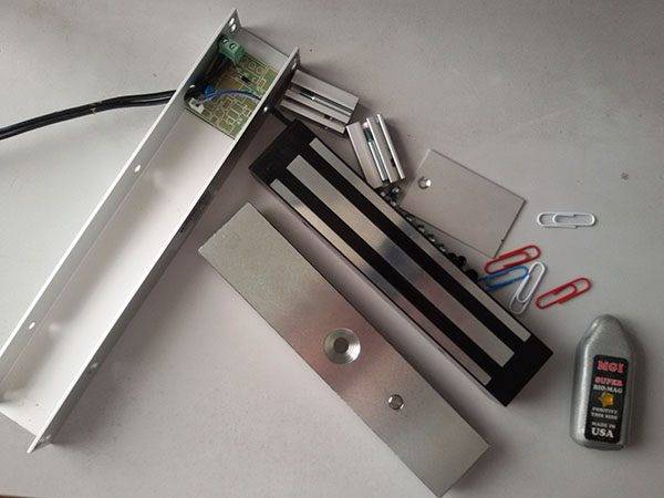

Ok. See picture above. I bought a magnetic lock with 600lbs holding force in order to figure out how such small device can hold 600 lbs (equivalent of 4 people hanging on it in the ceiling). I dismantle everything but couldn't open the black piece as it's one whole thing with black plastic integrated with whatever metal inside it at sides and bottom. Plugging it to a 12 volts 0.5A adaptor, it powers on and after sticking the shiny metal piece (below in the picture), it can't be removed by hands (because you need to apply 600 lbs pulling force). Testing it using a natural magnet.. the middle metal part of the black piece is positive and the sides negative. Ok. How does the coiling inside look like? I read using a core increasing the magnetic force many times. If you are to build it from scratch, how do you wind the magnetic wires in the cores? Clue: Also when I tried paper clips on the above compared to the natural magnets. The natural magnet can attract the paper clips at longer distance. While the paper clips stick to the magnetic lock only very close distance.

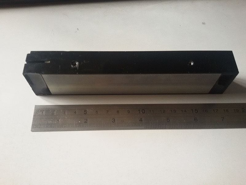

Here are more zoom in pictures of the above magnetic lock EM core with a ruler at its side:

oquen said:
1. Why are there no similar sized natural magnet that has holding force of 600 lbs??
there's lots available as you were told earlier in the thread
oquen said:
2. What's so special about electrical electromagnets in general such as the above with mere 12 volts and 0.5 Ampere of electricity that can so much holding force?
nothing special ... you are still attributing wonderful things to something very basic
oquen said:
3. I plan to melt the plastic enclosure to reveal it's coiling patterns and metal core.. any idea how to melt the black plastic? Or any non-demolition scanning of its internal?
for safety reasons, I really don't want to go there ... I suggest it could be a bad thing to doDave
