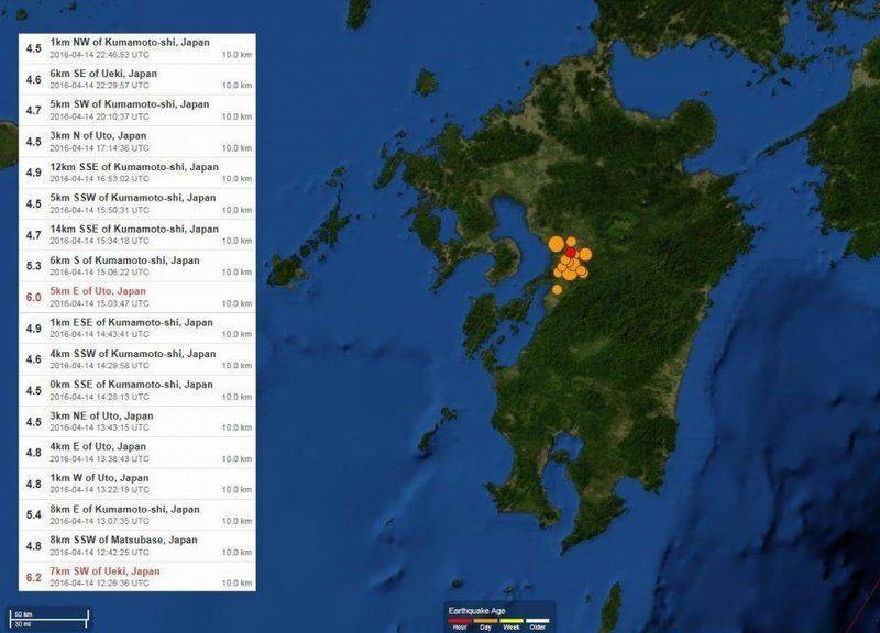

M6.2 - 7km SW of Ueki, Kyushu, Japan
32.849°N 130.635°E depth=10.0 km
This M6.2 mainshock was followed by a M6.0 and many other aftershocks

Followed last by this about 20 km SSE of the Mag 6.2
M6.0 - 5km E of Uto, Japan
http://earthquake.usgs.gov/earthquakes/eventpage/us20005i1a#general
2016-04-14 15:03:47 (UTC)
Location: Lat 32.679°N, 130.724°E
Depth: 10.0 km (6.2 mi) - shallow

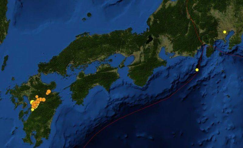

There's more interesting geological/tectonic happenings with these events in that region
that became blindingly obvious when I was looking close in at the SW Japan area and the earlier events
notice where the quakes have occurred ...
The SW end of a very long topographical feature in the land. Thought to myself, this has got to be a major fault system
looks just like the Alpine Fault in the South Is. of NZ and like sections of the San Andreas Fault system in California ( to name a couple)
After some digging I have found that this long fault zone is called the Japan Median Tectonic Line
It's the longest continuous fault system in Japan
https://en.wikipedia.org/wiki/Japan_Median_Tectonic_Line
At 5 - 10 mm/yr, the motion rates on this system are substantially less that the main plate boundary far to the southeast
which are around 55mm/yr. The main boundary taking up and releasing the majority of the accumulating stress in the region.
The MTL ( Median Tectonic Line) is a right lateral strike-slip fault. That means, if you are standing on one side of the fault and
looking across to the other side, that other side is moving to the right relative to you.Dave
