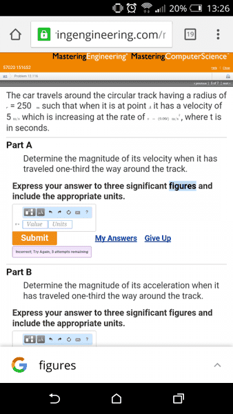

A car travels around a circular track with a radius of r=250m. When it is at point A then VA=5m/s which increases at a rate of a=(0.06t)m/s2. Determine the magnitude of its velocity and its acceleration when it is 1/3 around the track. My distance in this situation is obviously 524m.
Can anyone help please? I've seen numerous different answers but none of these are what I need. I've tried integrating it twice but this gives the value of t as a complex number which doesn't really help me.
Thanks in advance

That's the question. You can't see the ##\dot{v} on there but on the desktop version I assure you that you can
It's poorly worded. It should say speed, rather than velocity. In any case, if you really are given the magnitude of the acceleration as a constant, then Part B would be rather easy!
