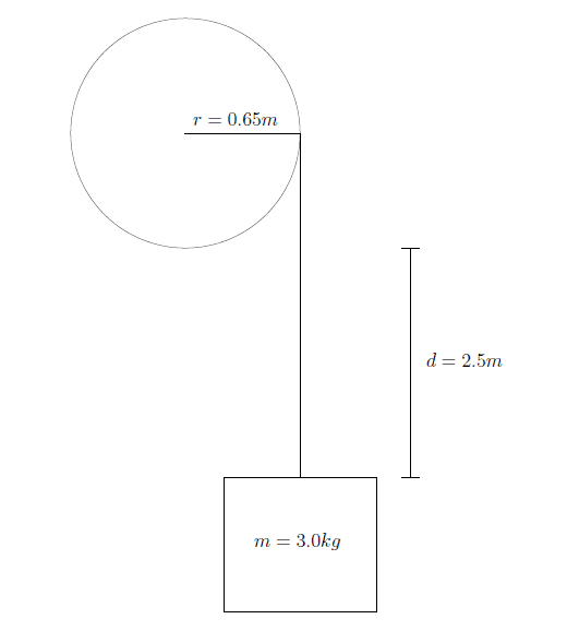

Consider a pulley with a mass-less cord attached to its edge. The rope hangs a distance of d= 2.50 m below the bottom of the pulley. Attached to the end of this cord is a block with mass 3.00 kg. There is also an electric motor attached to the pulley which supplies a torque of 28.7 N * m. The pulley can be considered a disk with a radius of 0.65 m. The mass of the pulley is 1.3 kg.
a) What is the torque due to the hanging block? Answer: 19.11 N ⋅ m
b) what is the moment of inertia of the pulley? Answer: 0.2746 kg ⋅ m
c) Once the motor is turned on the pulley begins to rotate counter clock-wise. What is the magnitude of the angular acceleration of the pulley? Answer: 6.22 rad/sec2
d) Through how many radians must the pulley rotate in order to lift the block to the bottom edge of the pulley?
e) Once the motor is turned on, how long will it take the top edge of the block to reach the bottom of the pulley?
I = 0.5 * m * r^2 (moment of inertia)
I need help with d and e.
[/B]
d) The circumference of the pulley is 4.08 m and the cord is 2.50 m. So the total rotation length is 1.58 m. How do i find how many revolutions from this? It should be less than 1 revolution, correct?
I don't knowwhat you mean by rotation length. You seem to have divided circumference by rope length, but that will not give a distance.
If the disc were to rotate one revolution, it would haul the rope up 4.08m. How many radians is one revolution? What fraction of that would haul it up the desired distance?

No, I think you have done the conversion backwards. Better to keep things symbolic as long as possible, so let the radius be r.
One revolution would haul 2πr. To haul length L, what fraction of a revolution is that?

Right. That is a fraction of a revolution, remember. How many radians is one revolution?

Right, so how many radians does a wheel of radius r need to turn to haul a length L?
(Please do not keep substituting numbers from the actual question. Keep it symbolic for now.)

f * 2π = L / r
ikihi said:
A fractional amount of 2π rad/rev.
f * 2π = L / r
Right. Do you see now why I pushed you to work symbolically? The πs cancelled, leaving a very simple formula for the number of radians.

d) asked for the number of radians. You have found it be be L/r. There was no need to do any calculations involving π since it canceled out.
