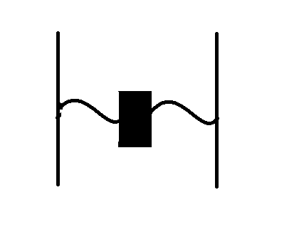

I've been looking at this thread, but I still have no idea what the set-up is meant to be... There are two vertical walls either side of a mass, which is held there because of two springs (each of which is attached to the mass and to one of the walls). And the idea is that the mass undergoes vertical oscillations. Did I understand it all OK? If so, I don't understand the reason for your starting equation...
I've attached a picture of what I think the experimental set-up is. Have I understood it correctly? p.s. the two wiggly lines are meant to be springs.
  • Hand-drawn diagram of a black rectangular block connected by two wavy spring lines to two vertical wall lines, one spring on each side of the block.
You have.

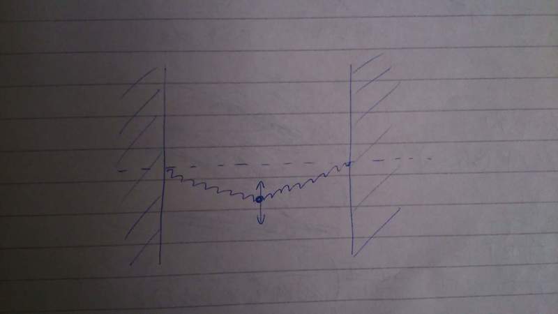

Hand-drawn sketch on lined paper of a mass hanging between two vertical walls, connected to each wall by a zigzag spring, with a dashed horizontal equilibrium line and a double-headed arrow showing vertical motion of the mass.
So, what exactly is supposed to be wrong with my starting equation?

Read the original problem.
We have two springs each 0.5m long and both have k=5N/cm. One end of the spring is attached to the wall while the other two ends are connected in the middle. On the junction point of the two springs a mass is hanged. How does the frequency of oscillation around equilibrium state depend on the initial offset due to the mass?
Hint: There is no need to explicitly write the initial offset as function of mass. Just use the offset as independent parameter using which mass can be calculated.
In equilibrium, the springs are stretched because of the weight of the mass. D is the initial offset of the mass, below the origin, (O in the picture) . The mass is slightly displaced from the equilibrium position. Find the frequency of the small oscillations in terms of D.
Skrat found the differential equation for the motion of the mass.
[tex]\ddot z = g - \frac{2kz}{m}\left( 1-\left(1+\frac{z^2}{L^2}\right)^{-0.5}\right)[/tex]
Expand the right side around z=D: Let z=D+ε. The right hand will have the form f(D)+(df/dz|z=D)ε.
[tex]f(D)=g+\frac{2kD}{m}\left( \left(1+\frac{D^2}{L^2} \right)^{-0.5}-1 \right)[/tex]
[tex]df/dz=\frac{2k}{m}\left( \left(1+\frac{D^2}{L^2} \right)^{-0.5}-1 -\left(1+\frac{D^2}{L^2} \right)^{-1.5}\frac{D^2}{L^2} \right)[/tex]
Simplified: [tex]df/dz=\frac{2k}{m} \left( \left(1+\frac{D^2}{L^2} \right)^{-1.5} -1 \right )[/tex]
f(D) has to be zero. If you know D, m can be determined.
[tex]ω^2=\frac{2k}{m} \left( 1- \left(1+\frac{D^2}{L^2} \right)^{-1.5} \right )[/tex]
I hope there is no error in the derivation. As I understood, use the approximation D/L<<1 when aswer to b).

BruceW said:
yeah, I get the same as ehild. And as ehild says, since f(D) is zero, this gives you an equation involving D,L and m. So if you are given some value for the mass, you could then in principle calculate D, and therefore calculate omega. Although the equation f(D)=0 is a little difficult to re-write for D, so this is probably why the question says you don't need to write the initial offset as a function of mass.
And the original problem suggest to express the mass in terms of D, which is much easier. And the result - ω in terms of D when D/L<<1 - is very simple an interesting.
Anyway, the frequency depends on the tension in the springs, and the tension is related to the offset, D.
hehe, yeah, I've added a comment about the approximation in my edit. I guess he would need to keep higher orders in the Taylor expansion right? There would be no motion to first order, but there will be in the higher orders.
This is a really nice problem in general. For the case of one spring, gravity just changes the equilibrium point, without changing the frequency. But in this case with two springs, gravity also changes the frequency. It's interesting, and kind of unexpected (for me at least). I like it when the answer to the problem is not just what I had expected it to be.
BruceW said:
edit: Also interesting, is that if we now apply the approximation ##D<<l## then our first-order term goes to zero. So if you want to apply the approximation ##D<<l## Then you will need to keep at least second order terms in the Taylor expansion. This is not a big problem, but it just means you need to do a bit more differentiation. I don't know if this is important for part b) ? part b) seems like a different problem...
ah, wait. what I said here is not right. It is more important to take ##\varepsilon## very small, than it is to take ##D/l## very small. So if you want to use the approximation ##D<<l## then you should not just let ##D/l## equal zero. But you can turn the equation:
into something much nicer, by letting ##D/l## be very small but not zero. So then, you still are just keeping the first-order term in ##\varepsilon##.
Bruce, you explain things for yourself quite nicely:smile:. I meant that the equation first-order in ε is
[tex]\ddot \epsilon+\frac{2k}{m} \left( 1- \left(1+\frac{D^2}{L^2} \right)^{-1.5} \right )\epsilon=0[/tex]
with D and L and everyting else constant. It is an equation for SHM, with [tex]ω^2=\frac{2k}{m} \left( 1- \left(1+\frac{D^2}{L^2} \right)^{-1.5} \right )[/tex]
In case (D/L)2<<1,
[tex]ω^2≈\frac{2k}{m} \left( 1- (1-1.5\frac{D^2}{L^2}) \right )=\frac{3k}{m} \frac{D^2}{L^2}[/tex]
Expanding f(D) [tex]f(D)=g+\frac{2kD}{m}\left( \left(1+\frac{D^2}{L^2} \right)^{-0.5}-1 \right)= g+\frac{2kD}{m} ( 1-0.5 \frac{D^2}{L^2} -1)\rightarrow g=\frac {kD^3}{mL^2}[/tex]
But you can also isolate ##\left(1+\frac{D^2}{L^2} \right)^{-0.5}## from f(D)=0 and substitute it into the equation for ω2 and expand after.
