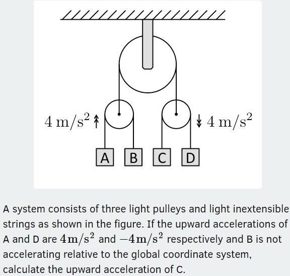

The answer is 'C = 0 m/s²'.
Connected particles?

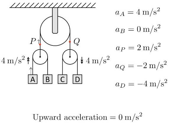

I don't understand the working shown on the website (seen above).
Firstly, they establish 'up' as the positive direction for acceleration, so A is +4 and D is -4.
They create two points, P and Q, and set acceleration values for them. I understand that connected particles have the same magnitude of acceleration, but I don't understand where they got '2' from.
The question states that B does not accelerate 'relative to the global coordinate system'. I looked-up this phrase, but I don't understand what it means.
This is what they say on the website: "The left-hand side of the system has two constraints: 'A = 4 m/s²' and 'B = 0 m/s²'. Looking at point P, these constraints mean that, for every 2 units that A rises in height by, point P rises by 1 unit." I don't know how they came to this conclusion.
Then, they say: "hence, the absolute acceleration of the connecting string is 2 m/s², so P = 2 m/s²." Again, why is it 2? I understand that Q must then be -2, but I don't get why P = 2m/s² in the first place.
I don't understand this question at all. Please help.
Think about the length of the string connecting A and B. If P moves up 1 unit, how much more string is on the B side? How much less is on the A side?

Before you ask why again, let's observe together what is happening:
B can't fall because the problem is telling us so.
We also know that C is not moving, according to the known answer.
Then, we could draw an imaginary triangle that connects B, C and the fixed support of the big pulley, which is not moving either.
Neither mass B, the center of the big pulley or mass C are moving respect to each other.
Only masses A and D are moving up and down.
The three strings are keeping its respectives lenghts while unfolding around the pulleys.
Forced by the friction of the strings, the three pulleys are rotating clockwise because C+D are heavier than A+B.

I have my own explanation of this, i ll try to expose it with as much detail as possible.
We can break the acceleration of A (and B) into two components:
  1. an acceleration ##a_{sA}## which is the acceleration relative to the left small pulley ( that is if we take the left small pulley like it is not moving)
  2. an acceleration ##a_P## which is the acceleration with which the left small pulley is moving relative to the big center pulley, that is relative to the global reference frame. This acceleration is the same as the acceleration of point P that's why I chose that name.​
The total acceleration of A (relative to the global reference frame) is (by superposition principle) $$4=a_A=a_{sA}+a_P\text{ (1)}$$
The total acceleration of B is similarly ##a_B=a_{sB}+a_P## where the ##a_P ## term is the same cause B is also moving together with the small left pulley, as this pulley accelerates up.
Now it is crucial to notice that ##a_{sB}## and ##a_{sA}## are the accelerations that B and A would have if it was like the small left pulley wasn't moving so it will be ##a_{sB}=-a_{sA}##.
So we will have $$0=a_B=a_{sB}+a_P=-a_{sA}+a_P\text{ (2)}$$
(1),(2) are a simple system which we solve we find ##a_{sA}=a_P=2##.

The question is complete, taken straight from here: https://i-want-to-study-engineering.org/q/pulley_dynamics_1/
Did you try a simpler problem among those before attempting solving the one we have been discussing?
This one is basically half as complex and the site shows a detailed solution:
https://i-want-to-study-engineering.org/q/pulley_dynamics_2/
It is important that you can see that both, velocity and acceleration of those pulleys, must be different and the reason behing that fact.
One (top-left) only redirects the tension of the string, while the other (bottom-right) has certain mechanical advantage (whatever it loses in force it gains in displacement and vice-verse).
I have attempted the original question from the beginning. It spans multiple pages of solving simultaneous equations, so this post will only show the equations without their derivation. This is what each variable seen in the equations refers to:

In the problem in this thread, we are not given any masses or tensions, and it is a digression to try to work with forces at all.
It is purely a kinematics problem. If you assign acceleration variables to all of the points that can move independently (each mass, each pulley) then you can write equations for the 'accelerations' of the lengths of sections of string.
Let the lengths of the vertical sections of string above these points be LA for the section above A, LP for the section above P, etc.
What equation can you write relating ##\ddot{L_A}, \ddot{L_B}##? Hint: start with an equation relating LA, LB and the (constant) total length of the string, then differentiate twice.
Next, what equation can you write relating ##a_P, a_A, \ddot{L_A}##?

Yes. Since the common mass centre of A and B is accelerating upwards, T2 must exceed the sum of their weights.
Delta2 said:
what do you think about my post #21
Yes, that is relevant and correct.
