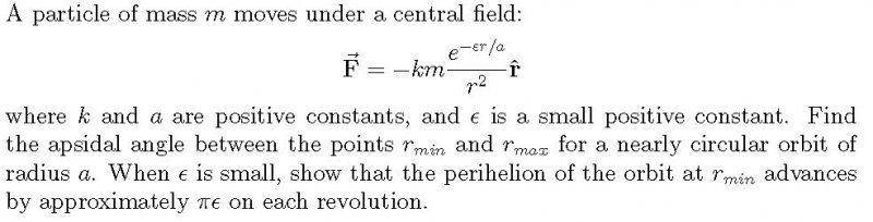

Attached.
Hi. This question has me really puzzled; I simply don't know where to start with this one and thus am not sure of any relevant equations. It seems to be a problem about small perturbations to the circular orbit of a body. I'm not sure of a strategy to pursue. Any help?
Thanks

With small perturbations and exponentials, I normally see the Taylor expansion of the exponential used to show properties.
