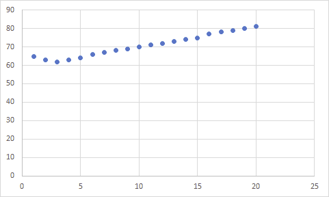

here is an example of some of the data I am seeing :

As you can see from the first 4 measurements, it does not produce a perfect sine wave

No, it looks like this:

That was only with 20 points, I could do more points and it would look more like a sinusoidal wave but
that would be a lot of points and I did not know how much was needed for this post.
If those 20 points are not representative, why did you post them?

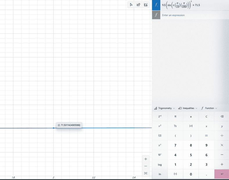

What am I doing wrong in my Fit equations?
if you look at the graph from my fit equation you will see that for angle 2 is say 71.50 but it should be 63. I do not even see 63 in the graph at all.
The lowest value I see is 71.5

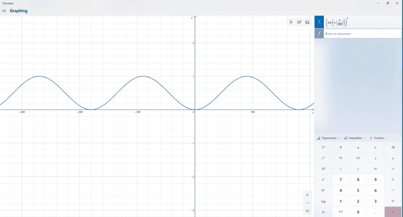

Can you show a plot of the full data set ? We still don't see that

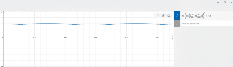

In addition it looks as if you can graph it. Just:
The vertical scale seems to be immense, so the fit looks like a horizontal line.

9.5 (Sin(x(π/10)(π/180)) ^2 + 7.15
So 9.5 is my A
you get A by Subtracting the biggest number from the smallest.
71.75 is my B You get B by adding the smallest number to the biggest number in the volume by two
I am multiplying my X by π/180 to converted from radians to degrees.
I am using sine squared to only get positive values.w = π/10 because my My period is 20 different values

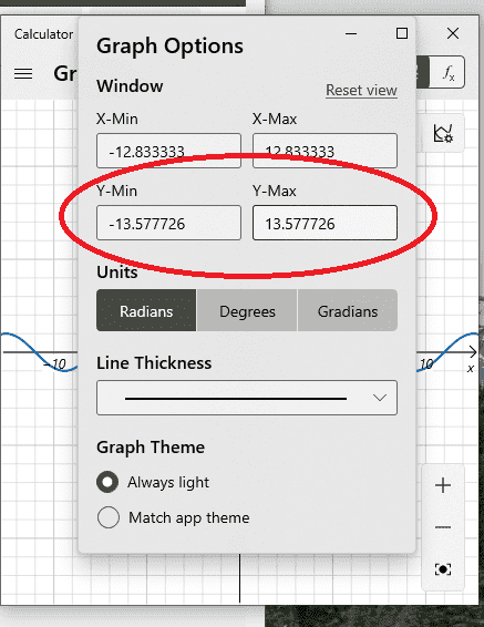

My real life vertical scale is only 0 to 360 degrees, that is just how the computer Graphing calculator works.

Are you suggesting that the data we see graphed in post #4 is all you have and you assume it's periodical ? That's not a sine, it is a sawtooth !
No you are not. You are multiplying it by (π/10) times (π/180)
Huh ? Are you seriious ?
There is no argument for that if you are fitting to ##A\sin \omega x + B##

y = 9.5 * intVal * intVal + 71.5
This makes no sense to me. If you're working with any of the trig functions, one period would be either 0 to ##\pi## (tan and cotan) or 0 to ##2\pi## (sin, cos, and their reciprocals). In degrees these would be 0 to 180 degrees or 0 to 360 degrees. The outputs (along the vertical axis) of these functions are real numbers, not measures of angles. If you graph ##y = \sin(x)##, all of the output values will be between -1 and 1. If you graph ##y = 9.5 \sin^2(\frac{\pi x}{10}) + 71.5##, with x in radians, all of the outputs will lie in the interval 71.5 to 81.0. The resulting curve does not look like a sine wave, as there are no troughs as in actual sine waves.

OH! right I remember that from school now. Sorry I think that YouTube video confused me.
so ##y = A\sin^2(x)## - period is ##\pi##, range is [0, A]
because my signal repeats every 180 180 degrees and that is π on a unit circle cool I understand that now.
So w = 2 because 2 π / π = 2
so now I have this:

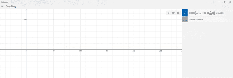

All I was able to get everything to work !
I can now graph a working Fit equation from my data by hand.
Thanks everyone that helped me
