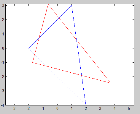

So to plot my first graph, I wrote this:
Code:
% triangle_ABC.m
clear all
P = [ 1 -2 2 1
 3 0 -4 3 ];
plot(P(1,:),P(2,:),'-b'), axis equal
Then I used the rotation matrix, and got this:
Mrot:
0.8660 -0.5000
0.5000 0.8660
I multiplied the matrix for the original triangle:
[1 -2 2; 3 0 -4]
with Mrot, and got this:
-0.6340 -1.7320 3.7320
3.0980 -1.0000 -2.4640
Then I tried plotting that in like so:
Code:
Q = [ -0.6340   -1.7320    3.7320 -0.6340
 3.0980   -1.0000   -2.4640 3.0980 ];
plot(Q(1,:),Q(2,:),'-b'), axis equal
But nothing happened.. I've tried google'ing how to draw multiple triangles in MATLAB but can't seem to find anything that fits my formula of drawing (and that's the one I have to use).
So my questions are: how to I plot multiple triangles into the same coordinate system - and how can I change the color?
Also, should I multiply the whole matrix for the original triangle, or should I do the vectors separated? Like coordinates for A * Mrot. Coordinates for B * Mrot and then coordinates for C * Mrot?
Thanks a lot for helping me out with this.

What I have done is checked other problems on the internet - and you're probably right that it's in the manual. What I found out was that there's a hold command, so I plot my graphs using this code:
Code:
P = [ 1 -2 2 1
 3 0 -4 3 ];
plot(P(1,:),P(2,:),'-b')[B],hold on[/B], axis equal
So, the blue triangle is the original, the red one is the one that's rotated 30 degrees in negative direction around the origin. Does the attached picture look correct? It should, but I can't think clearly after being frustrated with this simple problem for a couple of days.
Edit: Of course it looks right, looking that the formulas I've used and how the triangles look. Unless I'm completely wrong here, I'm moving on to my next exercise.
I don't see the original positions A,B,C in the plot. Where is C(2,4) for example?
Edit: Ah, probably a typo in the first post. But then the rotation direction looks wrong.

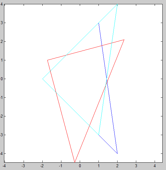

You're absolutely correct. I forgot the minus sign in front of theta = -30.
But even so, my mirror triangle, that should be mirror'ed around the x-axis seems wrong. I'm using
Mmir = [ 1 0
0 -1 ]
and
R = Mmir*P
R =
1 -2 2 1
-3 0 4 -3
plot(R(1,:),R(2,:),'-c')
But then I end up with the attached triangles. (I've now fixed the rotation direction)
Everything seems correct in my code. Surely, the R matrix is P matrix mirrored? Original is blue, rotated is red. Last one is the "mirrored" triangle.
Cyan is the blue triangle, mirrored at the x-axis.
Red is the blue triangle, rotated by -30 degrees.
Looks correct.
