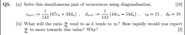

Solve this simultaneous pair of recurrences using diagonalisation
Not sure what would be related equations to this.

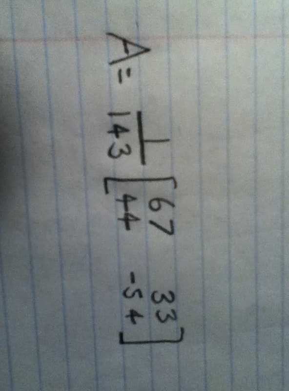

Originally I had no idea how to do this, I set up the first matrix, like this.
Then, from there, I know that I have to let:
x_k= [[c_k][d_k]]. Then x_k = A^k x_0,so you want powers of A. If you find its eigenvectors, then A = P * [[lambda_1, 0 ] [ 0, lambda_2]] * P^-1, so A^k is P*[[lambda_1^k, 0 ] [ 0, lambda_2^k]]*P^-1.
I just don't understand the syntax in this and how to put it to paper
Please give me a push in the right direction, I've been stuck on this problem all day.

The problem said you should use diagonalization of your matrix. First find the eigenvalues and eigenvectors.
Is A the correct matrix to diagonalise though? I did it out right now and usually on test problems our prof makes everything work out fairly nicely but this worked out to be:
λ^2 - 13λ -5070
Divided by 143 in front
λ^2 - 13λ -5070
It does work out sort of nicely. That equation at least has integer roots. Not nasty radicals. If this is a test question, I probably would have tried to find something nicer though.

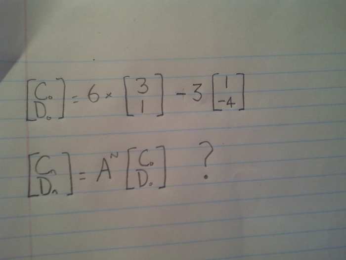

Fine. So now you've expressed (c0,d0)=6*(3,1)-3*(1,-4). Since (3,1) and (1,-4) are eigenvectors of A, it should be easy to write down an expression for (cn,dn)=A^n(c0,d0).
I'm sorry, I feel like I'm useless at this..
Do I not have to do the D= P^-1 A P stuff?

Try it! You found [c0,d0]=6*[3,1]-3*[1,-4]. You want to find A^n of that. You know how to find A^n of the eigenvectors, right?
Do I just do it the same way as before? Applying A to both sides?
So: A[c0,d0] = =6*A[3 1] -3 *A[1 -4]
Sure. But why not apply A^n to both sides? The left side becomes [cn,dn] doesn't it?
Oh damn, so it does.
So I'll have :
[cn dn] = 6*A^n[3 1] -3 *A^n[1 -4]
as the expression for cn & dn? or should they be seperate?
I'm guessing separate since it asks for a ratio in part b)
