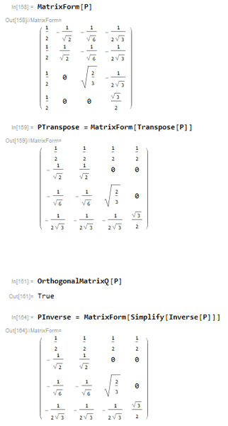

After that I checked if ## P ## is an orthogonal matrix; i.e. ## P^T = P^{-1} ##. Which indeed turns out to be the case and also the Mathematica command OrthogonalMatrixQ[] gives true back.
Mathematica session showing the 4x4 orthogonal matrix P in matrix form, its transpose PTranspose, the OrthogonalMatrixQ[P] result True, and the matrix PInverse, which matches the transpose.

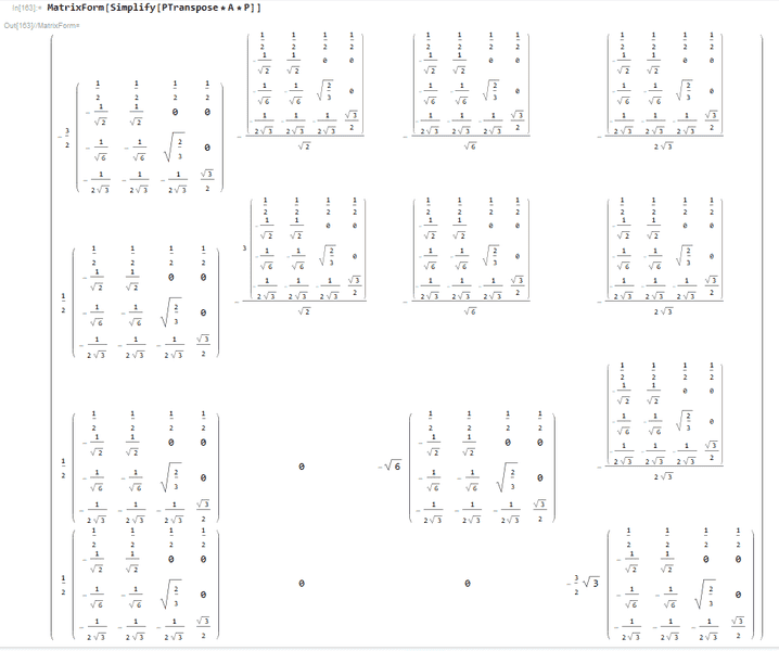

Lastly, I wanted to compute the diagonal matrix ## D ## by ##P^T * A * P = D##. But this turns out rather strange in Mathematica:
Mathematica output in a Wolfram notebook showing a large block matrix product labeled Simplify[PTranspose * A * P], with rows of fractions containing square roots of 2, 3 and 6, several zero entries, and a 4 by 4 pattern of blocks.
I am not sure what to make of this last result. I suppose I have made a mistake somewhere during the Gram-Schmidt Orthogonal Process. However, I cannot seem to find the mistake, if there is one. Also note that this is my first day working with Mathematica and the Gram-Schmidt Process.

You want to use . to multiply matrices in Mathematica, not * Try that.

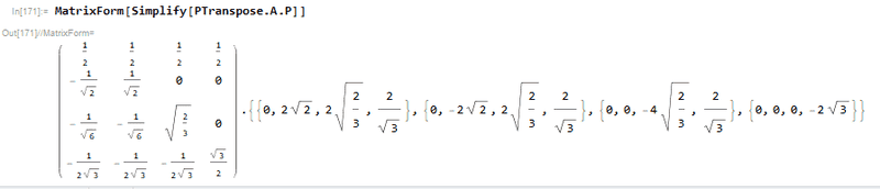

I just did that and it gives the following result:
Mathematica output of MatrixForm[Simplify[PTranspose.A.P]]: a 4x4 matrix of simplified surds and fractions multiplied by a list of four row vectors containing expressions such as 2 sqrt(2), sqrt(2/3), and -2 sqrt(3).

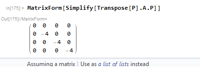

Oh my... I just used the following instead of ##PTranspose##
Mathematica session: MatrixForm[Simplify[Transpose[P].A.P]] returns a 4 by 4 diagonal matrix with diagonal entries 0, -4, -4, -4 and zeros elsewhere.
It seems correct, since the eigenvalues are on the main diagonal. However, why can't I define/use the name PTranspose to equal the transpose of P?

The problem is that you used MatrixForm when you defined PTranspose. MatrixForm converts it to a different form which looks nice, but which isn't the same as a matrix. If you eliminate the MatrixForm in your definition of PTranspose, it will work.
