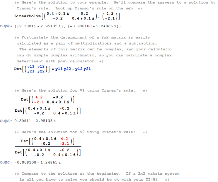

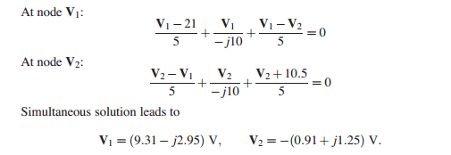

OK, just found out i cannot input complex numbers into matrices on my ti-83 plus. i have an exam coming up pretty soon, and here is a part requiring to solve simultaneous equations from a sample problem my teacher said might show up on it:
so i was wondring, is solving simulatneous equations with complex numbers doable by hand/calculator without matrix inversion, and if so how long that would take? if it helps using my calculator i worked out the matrix elements to be:
Code:
  [B]V1           V2 [/B]
[0.4+0.1i     -0.2] = [4.2]
[-0.2     0.4+0.1i] = [-2.1]
You can use Cramer's rule.

thanks. just finished my exam, went in there hoping for at most a 2x2 complex-number matrix because that's all i knew how to calculate, turns out there was only one problem like this and with a single node circuit too. so basically just a 1x1 matrix. which was easy, just used my calculator, no detreminants at all. thanks anyway :D
