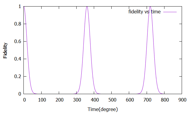

While increasing the degree( 0,30,60,etc) fidelity keeps on decreasing and reaches 0 (1,0.2,0,0,0...). So can I conclude that overlapping of the two quantum state decreases while increasing the degree(time)?
This is graph which I got while plotting fidelity vs time. According to my graph, fidelity decreases and reaches 0 but again increases and decreases.
From this graph what observations can be made?
