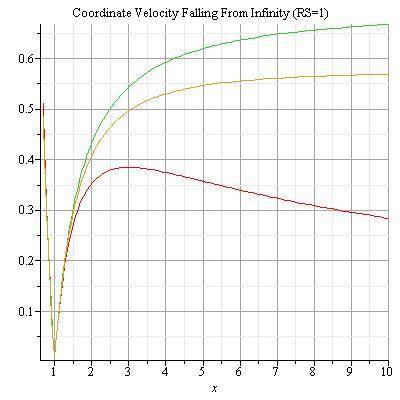

Assuming a system with relatively small but non-negligable mass falling from infinity to a maximally massive black hole;
Would there be a maximum possible coordinate velocity below c ?
Is it possible to do an approximate calculation for this?
A ballpark figure??
If there is a limit, what is the physics behind it?
A related question : Is there a minimal dilation factor for the clock of a Schwarzschild observer at infinity, independent of the mass of the gravitating body?
Thanks

Since you asked about the coordinate velocity falling from infinity I will add this here.
The formula is:
[tex] \sqrt { \left( 1- \left( 1-{{\it v0}}^{2} \right) \left( 1-{\frac {{<br /> \it rs}}{r}} \right) \right) \left( 1-{\frac {{\it rs}}{r}} \right) <br /> ^{2}}[/tex]
v0 is the initial speed at infinity, rs is the Schwarzschild radius.
The coordinate velocity does not have a maximum but this is a good opportunity to address a misunderstanding that many people have. A gravitational field does not necessarily accelerate an object towards the center of gravity. In fact above a certain velocity gravitation decelerates it, by the way, just like in the case of light.
See the attached graph for the coordinate velocity of 3 different scenarios (initial velocity=0, 1/sqrt(2) and 1/sqrt(3) ), you can see what I am saying.
Now you mention that the object in question has mass, for simplicity I assume you mean that in that case the object does not have to travel at c (by the way the formula I wrote above also works for c). If not then the problem becomes a lot more complex. Is that what you want to discuss?

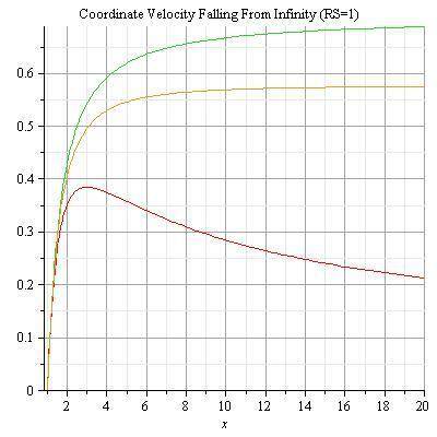

skeptic2 said:
What is the velocity profile of a free falling object inside the event horizon?
For coordinate velocity it is the same formula, I added a graph for that case as well (initial velocity=0, 1/sqrt(2) and 1/sqrt(3) ). You can determine it all the way up to, but not including R=0.

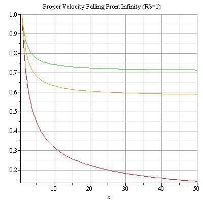

In addition we can also calculate the proper velocity (d proper length/d tau), a third graph (initial velocity=0, 1/sqrt(2) and 1/sqrt(3) ) will show this relationship, the formula is:
[tex] \sqrt {1- \left( 1-{{\it v0}}^{2} \right) \left( 1-{\frac {{\it rs}}{<br /> r}} \right) }[/tex]
  • Line graph titled Coordinate Velocity Falling From Infinity (RS=1), plotting coordinate velocity against x from 2 to 20 for three curves: green rises to about 0.68, orange to about 0.58, and red peaks near 0.38 at x of about 3 before falling to about 0.21.

  • Line graph titled Coordinate Velocity Falling From Infinity (RS=1), plotting velocity from 0 to about 0.65 against x from 1 to 10. Three curves start near 0 at x=1 and rise, one green curve approaching about 0.66, one orange curve about 0.57, and one red curve peaking near 0.38 at x=3 before declining.

  • Line graph titled Proper Velocity Falling From Infinity (RS=1), with x from about 0 to 50 on the horizontal axis and velocity from 0.1 to 1.0 on the vertical axis; three curves drop from near 1.0 and level off: green highest near 0.71, orange near 0.59, and red lowest near 0.15.
There are no stationary observers inside the horizon, so you can't define something like an absolute velocity.
yuiop's formula is also valid inside the horizon, if you redefine it to mean [itex]dr/d\tau[/itex], radial coordinate distance / proper time. That's not a velocity, though.
