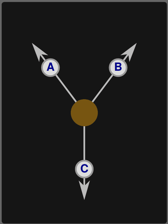

The Bowden Bomb
## \space ## This device is made of equal portions of matter and anti-matter, each in a quantity of ## M/2 ##. When triggered within a photon sphere, it explodes into three "fragments" (or just two when the bottom fragment is specified to be a mass of ## 0 ## or ##M/2##). Fragment A goes up and to the left, fragment B goes up and to the right, and fragment C goes straight down towards the event horizon. All three fragments consist of photons only.
## \space ## There is also a 3D version of this that has the same fragment C but sprays the remaining mass into a cone upward. For the purpose of this game, I do not believe the 3D version has any advantages over the 2D (3 co-planar fragments) version.

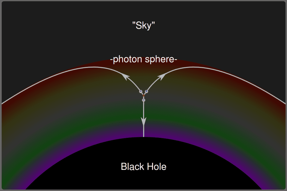

## \space ## Fragments "A" and "B" are directed to the edge of the apparent "sky" where they become ever aspiring to reach the photon sphere and thus marginally saved from the Black Hole.
## \space ## Fragment "C" is directed downward.

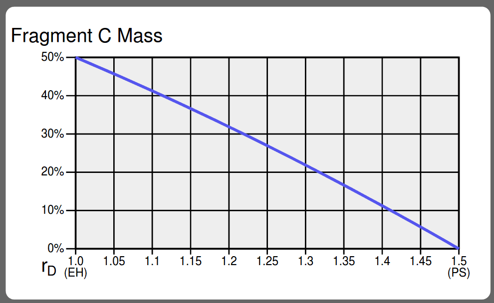

## \space ## The mass of each fragment is determined by the proportions required to balance the momentum and then scaled to yield a total mass of ##M##.
## \space ## I believe that fragment "C" and the vertical components of fragments "A" and "B" are lost to the Black Hole. Only the horizontal components are "saved". But I am not certain.

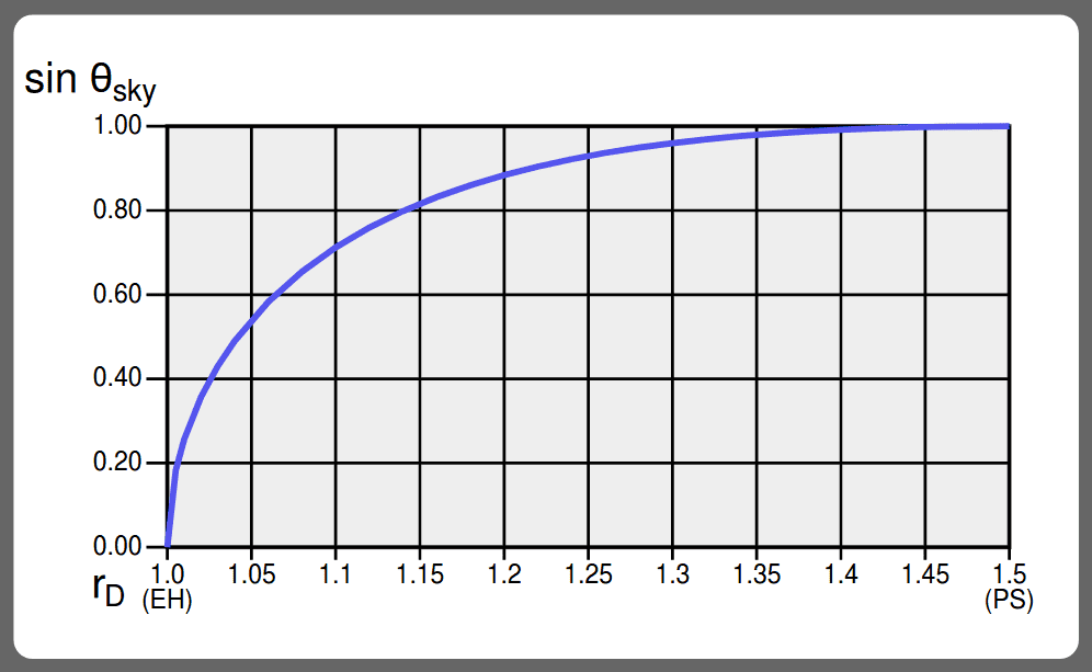

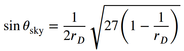

## \space ## Before this device can be programmed, we need to know the angle from vertical of the edges of the apparent sky. My thanks to @George Jones for this one:
## \space ##
As described in the OP, ##r_D## is a value from 1 to 1.5 to indicate the "elevation" of the player device. ## \theta_{sky} ## is the angle from vertical. For the device, the entire "sky" will appear to be above this angle. And the event horizon will appear below that angle.
## \space ## This sky angle is also the angle where fragments "A" and "B" will be launched. The masses of both of these fragments will be identical, so Fragment C must be directed exactly downward to balance the momentum. The vertical component of A and B will be ## cos \theta ##. To compute the fragment masses, take mass A=1 and B=1, then compute C (minus the sum of the vertical components of A and B), the scale to ## \frac 1 {2+2cos\theta} ## to bring the total back to ##M##.

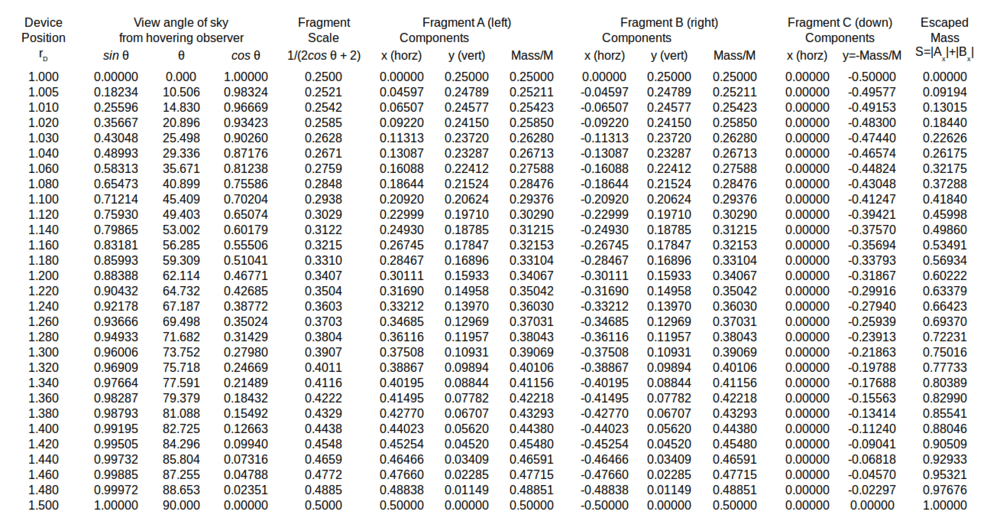

## \space ## Here is what the tally looks like:

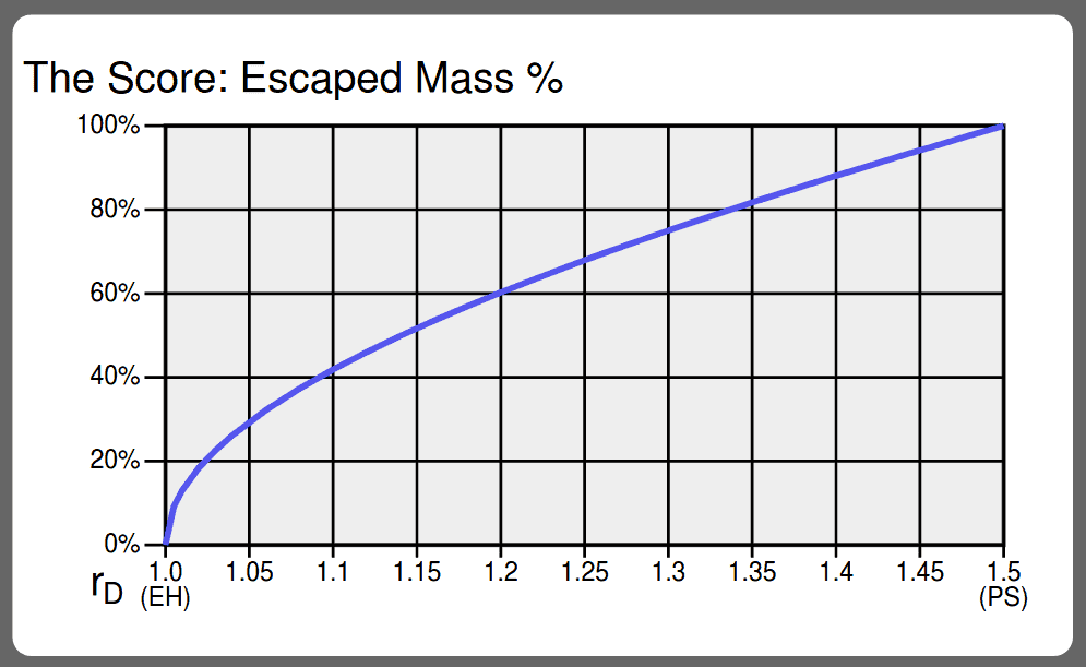

## \space ## Finally the Score: I believe what escapes from the BH is only the horizontal components of fragments A and B. That is what is shown in the table above.
Here are plots showing some of the data in that table. In all cases, the ##x##-axis represents the position of the hovering player device - from event horizon to photon sphere:
## \space ## I think for Level 2, all I need to do is treat the "explosion" as a 2-part event. First, arrest the fall of the device, then compute how much additional mass needs to be ejected downward, then once the total downward mass is known, compute what fragments A and B need to be.
## \space ## To be clear, I have not met the goal even for Level 1 because I have no demonstrated that this is an optimal solution.
Why are you doing this instead of just launching a fragment vertically upward? Any sideways velocity just decreases the amount of mass that can escape.
I don't know for sure what the optimum strategy is.
But certainly, just before it crosses the photon sphere, firing the fragments to the side saves everything and costs nothing. Since everything is in the form of photons, I don't think it matters how those photons make it to the photon sphere - so it's a matter of lobbing as much up there as possible.
If I fire something vertically up, then I would need to fire a corresponding mass downward - and that would be pure lost mass.
If I fire something closer to vertical than the sky horizon, then it will cleanly cross the photon sphere and probably succeed in carrying more mass - since I suspect it suffer less from red shift. But I think the cost of a vertical fragment outweighs the benefit.
From about ## 1.15 r_S ## to ## 1.5 r_S ## I am succeeding in freeing more than 50% of the mass - unless I am miscalculating.
The optimum strategy is to convert some fraction of the total mass of the object to energy and add that energy as kinetic energy to the rest of the object, directing the rest of the object radially outward. (Unless I'm misunderstanding something about the game; see my comment at the end of this post.)
