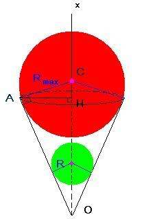

PROBLEM: A cone with a 30degree angle and a hieght of 1 must fit a sphere of icecream in it with a maximum volume.
what is that volume, and what percentage of the sphere is in that cone!?
PLEASE HELP!?
this is all i have
R= (h-a)(sin15)
a=distance between center of sphere and imaginary plane on top of cone.
i think R=0.2679 for the cone, but that doesn't help much, just basic law of sines... I'm not sure how to set up the dirrivative to maximize V for sphere with this information...

Err... I don't think we need any derivatives to work out the problem.
The center of the spherical ice-cream ball should always be on the Ox axis, so that it can fit the cone (see attachment):
The radius of the sphere is the distance between the center and one of the two sides of the cone.
Note that the volume of the sphere is [tex]V = \frac{4}{3} \pi R ^ 3[/tex], so when R is largest, V will also be largest, right?
Looking at the image, what's the maximum value of R?
Can you go from here? :)

Have you found out the maximum value for R from my previous post? It should be easy, since you have the height of the cone, and the angle.
for the cone i believe the imaginary R = .2679 for circular plane at top, but the R for sphere is a variable still...
Ok, look at the attachment again, I've edited it. A little bit messy, but hope you can see it. :)
So, we have:
OH = 1 (problem stated).
Angle AOH = 15 degrees.
C is the center of the sphere.
We also know that AC is perpendicular to OA (so that an ice-cream should fit in the cone). The radius R of the sphere is AC. Can you find AC?

Wait, just want to ask, is this the maximum volume for the ice-cream ball, or the maximum volume of the part of that ice-cream ball in the cone?
EXACT PROBLEM:
you place a sphere of ice cream into a cone of hieght 1
1. what radius of the sphere will give you the most volum of ice cream inside the cone (as opposed to above the cone) for a cone of base 30 degrees?
2. what is that volume inside the cone and what percentage is inside the cone and outside the cone?
r for cone i believe is .2679
and I'm not sure how to solve for r of sphere to achieve a maximum volume inside the cone...
i did calculate one theory that i had and found radius to be .230
any thoughts?
