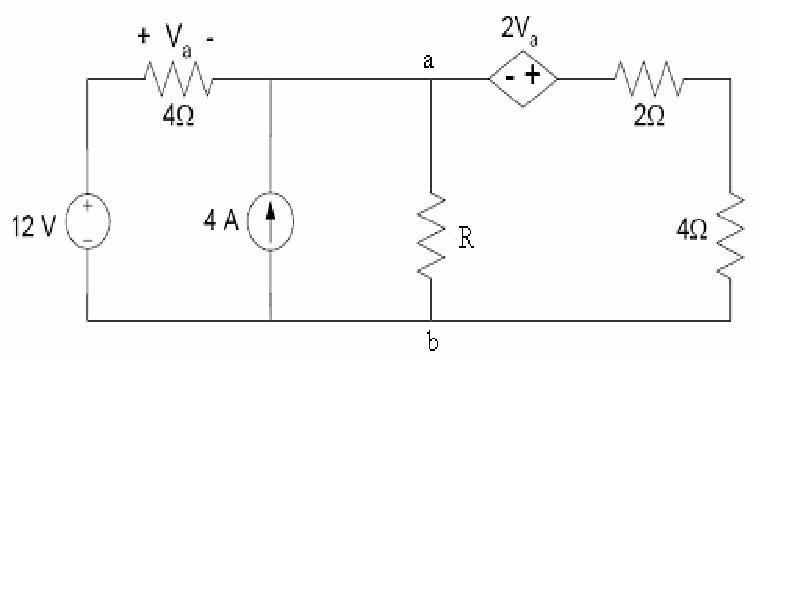

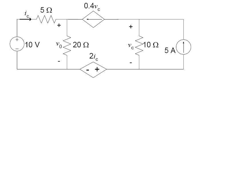

Question 1
Use the Mesh analysis to find v
0 and power absorbed by the 20 resistor in the circuit
Question 2
a) Find the Thevenin equivalent circuit external to the resistor R
b) Find the condition under which maximum power is transferred to R
c) Determine the maximum power transfer to R
Does anyone know how to solve them I tried them but it didnt seen right and the dependent source is so annoying is there any way to get rid of them? thanks
p.s untitiled is question 1 and 2 for question 2 thankz

i got Vo + 24v don't know if that's right and quesrion 2 I am bit confused i got Rth 10ohms sound right?
Need great help thankz
There is no way to cancel dependent sources. Show what you have done in question 1 in order to be helped.
For question 2. Va is the difference between the 10V source and the open circuit voltage Vab. Develop your analysis and you will have one equation with one unknown: Vab.
In order to calculate the equivalent resistance, the best approach with dependent sources is to use Rth = Voc/Isc. You already have Voc. Short circuit terminals a and b and calculate Isc.
i get number one now i have I1 as -2.585A ,I2=-3.732A ,I3=-5A
AND V0= (I1-I2)R= 23V AND POWER = 26.45W

Sorry! I meant 12V, not 10V. And Vab = Vth.
so is Rth = 4+2+4=10?
and Vth =
(Vth-2Va)/4 +Vth -12/4 -4=0
5Vth-4Va=84
what's Va?
12V/4=3A
3+4=7A
7*4=28v=Va?

Write the equation for the outside mesh, using Va as unknown. Remember that the current through the resistors 2 ohm and 4 ohm after the controlled source is the sum of the current through the firsr 4 ohm resistor with 4A of the current source. From this I found Va = -24V and Vab = Vth = 36V.
Next, short circuit the points a and b and calculate the current through them, Isc.
Rth = Vth/Isc.
CEL can you write out the equation coz i can't get anywhere close to 36V for Vth!
I did node a (Vth-12)/4 -4+ 2Va+Vth/6=0
Vth equals 14 sth and not even -24 or 36 I am really really lost and i spend any hours on this still can't finish part A how do u do part B and C

Calling Ia the current trough the 4ohm resistor:
Ia = Va/4
The outermost mesh:
-12 + Va - 2Va +(2+4)(Ia + 4) = 0
or
-12 -Va + 6Va/4 + 24 = 0
12 + Va/2 = 0
Va = -24V.
Vth = 12 - Va = 12 + 24 = 36V.

When you short circuit points a and b you get two independent meshes: one with the two independent sources an one resistor and the other with the dependent source ant two resistors. Work from there.
k i have loop 1 as -12 +4I1+16=0 and I1 =-1A
loop2 as -48+6I2=0 then I2=8A
is this what u mean in the last post and if so Isc= (I1-I2) = -9A
is Rth become -4?

Where did you get the value 16 in the first equation? Loop 1 comprises the 12V source, the 4 ohm resistor and the short circuit ab.
so u mean loop1 as -12+4I1=0 SINCE SHORT CIRCUIT AB IS THERE?
I1=3 BUT IS LOOP 2 RIGHT?
THEN ISC = -5A, Rth = -36/5

It is wrong. Don't forget that the current source also flows through the short circuit and that Va has now a new value that must be substituted in the dependent source.
so what do u do with the current source then
ya VA was sub and loop2 = 2*-24+2i2+4i2=0
-48+6i2=0
i2=8A isn't that it?
and is ISC=(I1-I2)? IM KIND OF CONFUSED

Where did you get the -24 value? Va = 4i1!
You have 3 currents through the short circuit: i1, i2 and 4A from the current source.

There are 3 loops:
1. The independent voltage source plus the 4 ohm resistor.
2. The current source.
3. The dependent voltage source and two resistors in series,
anthony0118 said:
-12+4i1+16=0 loop 1
Where did you get the 16 V value?
what do i do with the 4A in this loop do u do source converction? and change it to voltage? then that's 16V 4A*4OHMS
The source and the short circuit form a loop.
coz VA =-24V AND 2VA=-48V for the dependent source
2 and 4 ohms are added up
-48+6i2=0 and this is loop2
No, Va was -24V when there was an open circuit between points a and b. Now there is a short circuit there, so you must write new equations.
and one thing is Isc=(i1- i2)? if so how that make sense i have a negative number for current
that is how i arrive at that point and I am sorry i can't get it any further
No, there are 3 currents through the short circuit.
