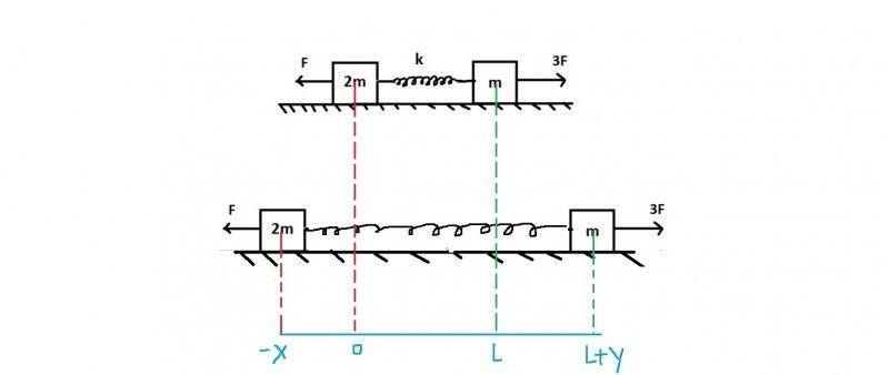

In the figure shown below all surfaces are friction-less. Find the maximum extension in the spring(in meters) , if the blocks are initially at rest and the spring is initially in its natural length.
Details and Assumptions:
F=30N
k=700N/m
m=5kg
[/B]
Let the displacement of ##2m## be ##x## and that of ##m## be ##y##
Applying work energy theorem on block 1 (##2m##) and on block 2 we get
##Fx-\frac { 1 }{ 2 } k{ (x+y) }^{ 2 }=\frac { 1 }{ 2 } (2m){ v }_{ 1 }^{ 2 }##...(1)
##3Fy-\frac { 1 }{ 2 } k{ (x+y) }^{ 2 }=\frac { 1 }{ 2 } (m){ v }_{ 2 }^{ 2 }##....(2)
##{ X }_{ COM\quad }=\frac { ml }{ 3m } ## Position of CoM initially.
##{ X }_{ COM }=\frac { -2mx+m(L+y) }{ 3m } ## Position of CoM finally.
##\triangle { X }_{ COM }=\frac { my-2mx }{ 3m } ##
##{ a }_{ com }=\frac { 2F }{ 3m } ##
##{ v }_{ com }=\sqrt { 2\frac { 2F }{ 3m } \times \frac { my-2mx }{ 3m } } ##.....(3)
Elongation in the string will be maximum when velocity of block 1 would be zero.
Putting this in (1) I got
##3x=35(x+y)##...(4)
On solving eq(2) and substituting eq(4) I got
##V_{2}=\sqrt(36y-12x)##...(5)
As ##m_{1}v_{1}+m_{2}v_{2}=(m_{1}+m_{2})V_{com}##
So ##3V_{com}=v_{2}##
Using eq(5) and (4) I got
##-y=3x##
Am I correct till here?

I don't understand your equations 1 and 2. Aren't you counting the energy in the spring twice, once for the distance F moves and once for the distance 3F moves? Just consider total energy.
What is the relationship between the velocities at maximum extension?

At maximum compression velocities of the blocks along the line joining them should be equal but this is a case of maximum extension. I think the extension would be maximum when velocity of mass ##2m## is zero.

I don't see how you can do that. You have counted the total spring energy in each, so if you were to add them together you'd have too much. And there's no obvious way to apportion the spring energy between them.
So? Why wouldn't it be the same result for the velocities?

Work done by all forces is equal to the change in the kinetic energy of the system. Taking block of mass ##2m## as a system. So
Work done by F is ##+Fx##
Work done by spring ##-\frac{k(x+y)^{2}}{2}## -ve sign because force exerted by the spring is in opposite direction of displacement.
Change in kinetic energy is ##mv_{1}^{2}## as the initial velocity was zero. Equating then I got eq(1) similarly I got eq(2).
What am I doing wrong?
Satvik Pandey said:
Work done by F is +Fx
And what is the work done by the force on the other block?

Kinetic energy is ½mv2, right? So, according to your statement, the blocks should not have any kinetic energy when the spring has reached maximum extension.

I was making a mistake. I got that. The extension would be maximum at the moment when the relative velocity of the blocks along the line joining them would be zero.

k(x+y)2/2 is the total work done on the spring. You have both forces doing that much work on the spring.

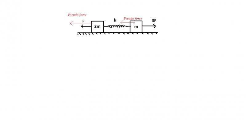

Let us consider block 1,block 2 and spring as a system.
So work done by all the forces is equal to the change in the kinetic and potential energy of the system.
##Fx+3Fy=\frac{k(x+y)^2}{2}+\frac{3mv^2}{2}## (extension would be maximum if velocities of blocks are equal).

I revised the chapter of Center of Mass last night and I found that this can be solved even in a more easy way.
Let us consider two blocks and the spring as a system.
Net external force acting on the system is ##2F##
So by Newton's second law acceleration of the CoM of the system
## a_{com}=\frac{2F}{3m}##Consider a reference frame which is moving with the CoM of the system as it is a non-inertial frame of reference so we have to include Pseudo force on the blocks.
Let the displacement of block of mass ##m## be ##x## towards right and that of 2m be ##y## towards left as seen from the CoM of the system.
Work done by all the external forces on the right block is ##(3F-\frac{2F}{3})x##Work done by all the external forces on the left block is ##(\frac{4F}{3}+F)y##
This work done is equal to the change in the potential and kinetic energy of the system. If the extension has to be maximum then velocities of the block wrt CoM of the system should be zero. So the final kinetic energy of the system is zero.
##(3F-\frac{2F}{3})x+(\frac{4F}{3}+F)y= \frac{k(x+y)^2}{2}##Solving this equation I got ##x+y=0.2## which is the right answer.:smile:
