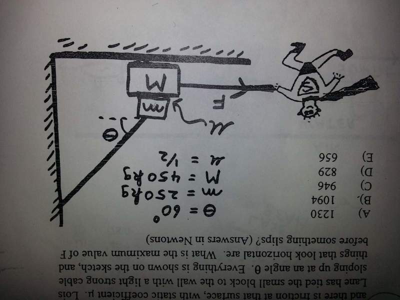

Superman is regaining his strength by pulling with a force F on a large block of mass M resting on a frictionless floor as shown. A small block of mass m rests on the upper surface of the large block, and there is friction at that surface, with static coefficient μ. Lois Lane has tied the small block to the wall with a light strong cable sloping up at an angle ∅. Everything is shown on the sketch, and things that look horizontal are. What is the maximum value of F before something slips? (Answers in Newtons)
∅- 60°
m=250kg
M=450kg
μ=0.5

*Check attachment for a picture.
F=ma, Ff=Fnxμ,Fnet=F1+F2+F3
I drew the FBDs for both masses, but I do feel i did something wrong.
for mass m, I had Tcos60° upwards, Tsin60° to the right, Ff to the left, and Fg facing down.
for mass M, I had Fg facing down, Fn facing up, and Fnm [Normal force of mass m] also facing down.
That's as far as I got.
*The picture is upside down, sorry!
  • Physics diagram, upside down: large block M on a frictionless horizontal surface pulled right by force F; small block m on top, tied by a cable sloping up at angle θ to a vertical wall. Labels: θ = 60°, m = 250 kg, M = 450 kg, μ = 1/2.
I think you have the cos and sin swapped.
You've left out the horizontal forces on mass M.
Please write out the static force equations for the two directions one each mass. You know what Fg is for each mass, so don't write it in that form (especially as having two forces with the same name is confusing).
