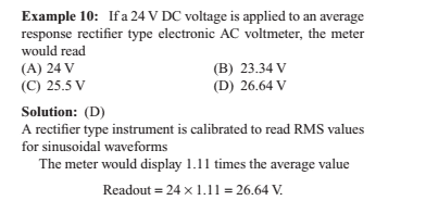

Textbook example showing a multiple-choice question about a rectifier-type AC voltmeter reading a 24 V DC input, with options 24 V, 23.34 V, 25.5 V and 26.64 V, followed by the solution (D) and the calculation Readout = 24 x 1.11 = 26.64 V.
For sine wave RMS/Avg = 1.11
For DC, RMS = Avg = Peak Value
I didn't understand the solution. There is a 24V DC supply. I give it to an AV Voltmeter. The Voltmeter responds to average value. So the voltmeter would give 24V DC. So Answer should be A. I know that RMS / Avg = 1.11 for sine wave. But I didn't understand what they've said in solution.
Can somebody help me out?
  • Textbook example showing a multiple-choice question about a rectifier-type AC voltmeter reading a 24 V DC input, with options 24 V, 23.34 V, 25.5 V and 26.64 V, followed by the solution (D) and the calculation Readout = 24 x 1.11 = 26.64 V.
The voltmeter measures the average voltage, and since it is an AC voltmeter, it reports the RMS by multiplying the average by 1.11. Since it is sampling a DC signal, it gets an average of 24 V, but still assumes it is AC and applies the same multiplication factor.
