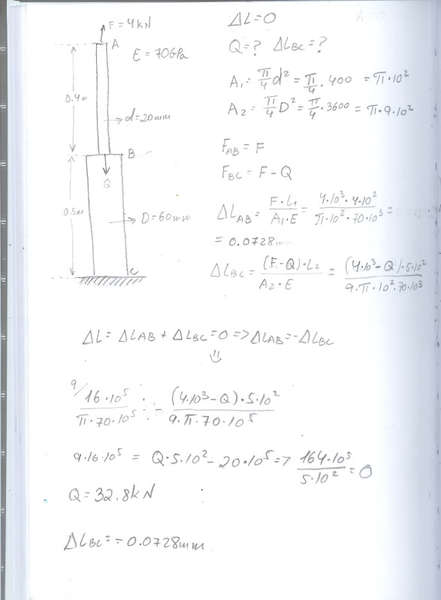

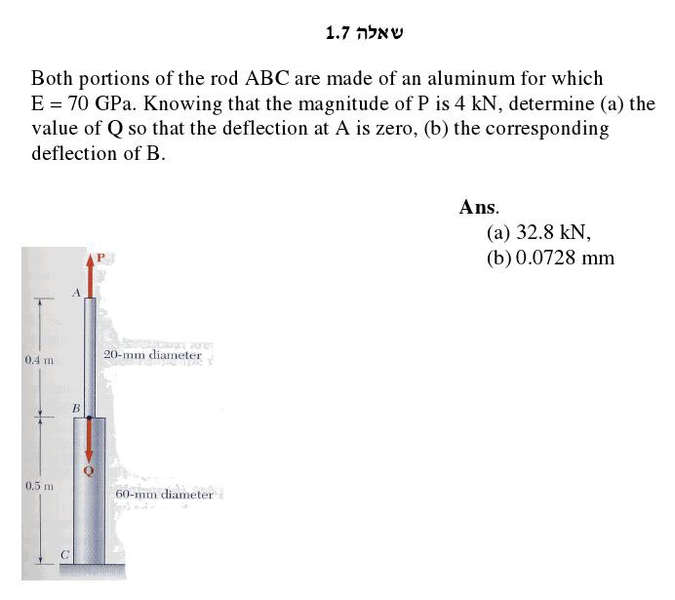

Got it. Thanks :smile: Aherm, I don't while I got you here (and I don't really want to start a new thread), I have the full solution of this question
http://img100.imageshack.us/img100/1631/prrobbb.jpg
where I have to find stresses through the rod and total distortion
But I appear to be one decimal point wrong. Can you find it? My friend actually solved it and I confirmed her solution, I even resolved it on another paper and got the same result. Are we wrong or are the teacher answers wrong?
here:
http://img689.imageshack.us/img689/8797/hersol1000.jpg
IMHO your answer is right and the teacher's answer is wrong.
Aha, I knew it :smile: Thank Klaas, this helps confirm and I will show it to my teacher on Friday.
