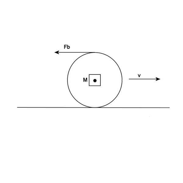

The inspiration for this question came about when I was coming down a mountain at top speed on my mountain bike and was thinking about how braking works on a wheel and whether a skid can occur if enough braking force is applied and the wheels don't actually lock.
To make things simple, take a single wheel rolling along a level surface. The wheel is weightless so there is no moment of inertia to take into account, just say there is a mass M attached to the axle. If a braking force is applied at the perimeter of the wheel and this produces a sliding friction force Fb acting against the direction of rotation of the wheel, what are the forces involved and how do you work out the deceleration of the wheel? The velocity of the wheel is v.
The way I would approach things is to resolve Fb into a couple Fb and a force Fb acting against the direction of motion at the axle and then the equation of motion becomes:
-Fb = Ma where a is the deceleration of the wheel. Is this correct?
