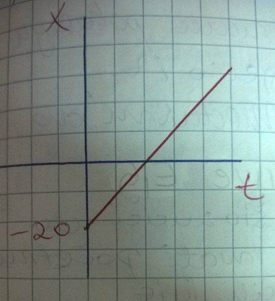

I have one more problem to solve can someone help me? It goes like this :
At t=0, a particle moving along an x-axis is at position x0 = - 20 m. The signs of the particle's initial velocity v0 (at time t0) and constant acceleration a are, respectively, for four situations: (1) +, +; (2) +, - ; (3) -, +; (4) -, -. In which situations will the particle (a) stop momentarily, (b) pass through the origin, and (c) never pass through the origin?
I started like this :
As I have understood this, the particle is starting to move from negative area. Now in the first situation ( +, +) beacuse it is negative area it is starting foward ( because initial velocity is + ) but slowing down because acceleration is + so it should stop momentarily or it is moving foward and slowing down but moving away from the origin so it won't pass through the origin ( I am not sure if any of these is correct )
In the second situation ( +, -) the particle is driving foward (away from the origin) but accelerating ( because acceleration is - ) so it won't pass through origin.
In the third situation ( -, + ) the particle is starting backward but slowing down (acceleration is + ) so it should stop momentairly.
In the fourth situation ( -, -) the particle is moving backward but accelerating so it should pass through the origin .
So the answers are : (a) is (3) and maybe (1)
(b) is (4)
(c) is (2) and maybe (1)
Am I right ?
Motivanka said:
I don't know if points 2 and 6 are equal to initial velocity. Can I read it from graph? Or maybe because they are in the same level ?
I'm sorry for the misunderstanding. What I meant here is that point 2 and point 6 should be halfway from points where acceleration is zero, as tommyxu3 has said.
As for your new question, I think you misunderstood some points.
A positive velocity and a positive acceleration denotes an increase in velocity, and traveling to the positive axis.
A positive velocity and a negative acceleration denotes a decrease in velocity, and traveling to the positive axis.
A negative velocity and a positive acceleration denotes a decrease in velocity, and traveling to the negative axis.
A negative velocity and a negative acceleration denotes an increase in velocity, and traveling to the negative axis.
In summary, if both the velocity and acceleration have the same sign, it is speeding up. The velocity's sign will tell you where the particle is traveling to (opposing where the particle is currently is).
So If a particle is in a positive area of graph and it has negative velocity and positive acceleration it is traveling to negative axis but slowing down and if it has negative velocity and negative acceleration it is traveling to negative axis but getting more speed because acceleration is positive. In the other two cases if velocity is positive the particle is traveling away from negative axis ( it will move deep in positive axis ).
And if the particle is in negative area of graph and it has positive velocity and positive acceleration it is traveling to positive axis and accelerating and if the particle has positive velocity and negative acceleration it is traveling to positive axis but slowing down. In other two cases if velocirry is negative the particle is traveling away from positive axis ( it will move deep in negative axis)
Did I get it right ?
I think you meant here is that acceleration is negative.
A. T.'s suggestion is a good reference, and here's another one: http://www.physicsclassroom.com/mmedia/kinema.
As a side note, I think you're getting confused on the particle's position and the signs of velocity and acceleration. The particle's position has no relation whether the particle is slowing down or speeding up. The sign of both velocity and acceleration matters.
Yes, I meant that acceleration is negative. My mistake
Thank you, you have helped me a lot :)
