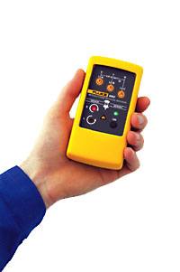

I've watched handheld meters like this on small motors.
http://www.fluke.com/fluke/auen/electrical-testers/Electrical-Testers/Fluke-9062.htm?PID=56153
You have to turn the shaft a little by hand. I'm not sure how you'd do that on a several thousand horsepower motor.

Place an analog ohmmeter across the winding of an induction motor , like say your electric fan. Give the shaft a turn and watch the needle briefly deflect.
The DC current from the ohmmeter is making a small magnetic field in the motor. When you rotate the shaft rotor current flows and induces small counter-emf in the windings, hence the small dip of the meter needle .
Handheld phase checkers like that Fluke and Megger use that effect to figure out phase sequence on a 3 phase motor.
I never saw one used on a really big motor though, probably because it'd be impractical to turn the shaft by hand. But i'd bet somebody sells a gizmmo for making that check.
