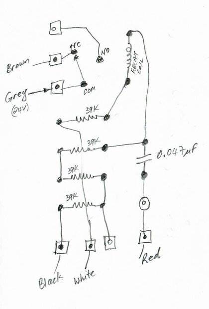

I have been given an electrical chain hoist to repair. The symptom is that it suddenly stopped working.
I have checked the motor's windings and they each show similar DC resistance of 0.0018 ohms.
I have attached the schematic (dunno why it was rotated 90 degrees during the upload).
The hoist operates from 3-phase mains. Its up and down motion is controlled via push buttons which are supplied with 24 volts AC from a step-down transformer connected across 2 phases. The push buttons operate a reversing contactor which, via the up/down limit switch, swaps one of the motor's phases to effect forward and reverse modes. I have ascertained that the 24 volt circuit is working correctly as is the reversing contactor.
I have also ascertained that the reason the hoist is not operating is that the normally-closed relay that I have highlighted in the schematic is energized as soon as power is applied to the hoist, the effect of which is that the 24 volt supply is interrupted thus rendering the up/down control function inactive.
I don't understand the highlighted area of this circuit and would appreciate help with it. Specifically, which condition would leave the relay in its normally-closed position (and thus allow the hoist to operate) as opposed to the condition that causes it to go to normally-open (and thus inhibit hoist operation)?
Note that all 3 phases are connected to it. The coil is rated at 220V AC, i.e. the voltage of one of the phases.
I don't really understand the way the highlighted relay is drawn. If it was a 'black box' I'd be pretty confident that it is a 'phase loss' and/or 'phase rotation' device. It protects the motor from being 'single-phased' and the operator from unexpected 'backward operation.' In spite of the way it's drawn, I suspect that's what it is. Best guess: You're missing a phase or your rotation is swapped.
Edit/add: Or the highlighted relay is bad.

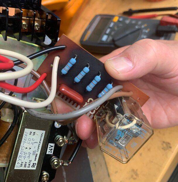

I have attached a sketch of the board's layout and a photo of it. Note the resistors perched above the PCB's surface for ventilation and the scorch marks on the board, so they have been running hot at some stage of this hoist's 27 year lifetime. The 39k resistors still measure a tad less than 39k.

Now, it's a pretty basic setup. You have four resistors that have been rather hot. Assuming you know what the values are supposed to be based on color bands, test them.
Have done that. As per my post #4 "The 39k resistors still measure a tad less than 39k."
Averagesupernova said:
Components that have been hot for extended periods have a tendency to develope poor connections to the board. Check that as well as damage to the tracks on the board itself.
Yep, and the solder joints are still in very good condition.
It seems the relay does pull in. Can't be an open coil. Only thing left is the capacitor has failed or for some reason one of the phase conductors to that little board is open. It's not that difficult.
Tested all of that already.

There are no internal components. The hand drawn diagram I provided shows exactly what is on that board.

Yet again, there are no "internal parts not shown". What I have sketched is exactly what is on that board.
There is nothing mysterious about the relay itself. It's simply a common or garden SPDT (Form C) with a 220 volt coil.

What are the values of the resistor and the capacitor shown inside the sequence detector?
A fair possibility is that the Capacitor in the phase-detect circuit has failed. It could be either shorted, open, or possibly changed in value due to a hard life.
I suggest that if you can readily get a replacement capacitor that you do so and just replace it as part of troubleshooting. Be sure to get a capacitor of with at least the same, or higher, voltage rating and also a similar style and physical size. The physical size can be important to dissipate any internal heat it generates.
If the marking on the capacitor are visible, please post a closeup photo of same. If the markings have disappeared over time, I would start looking in the catalogs for a Sprague "Orange Drop" capacitor with a voltage rating At Least 3 times the line-to-line supply voltage.

Do you believe that the board in question is in fact able to detect a phase swap? I am very very very confident that is it's purpose. Assuming you have accepted this, here are some pitfalls:
You say you have all three phases present on the board. Be cautious here. You still may be measuring voltage but it may be from another leg feeding your voltmeter from a different path if you have a broken conductor en route to the board. The volt meter tells you voltage, not phase. Phase is what it's all about on this board.
Think of the circuit as a summing circuit. The capacitor shifts the phase in such a way as to be either additive or subtractive to act on the relay all dependent upon incoming connection.
Cheers,
Tom
p.s. please keep us posted on your results!
Thanks Tom. You are likely on the money given that the other components seem to check out and the resistors have clearly been running hot at some period of the hoist's life.

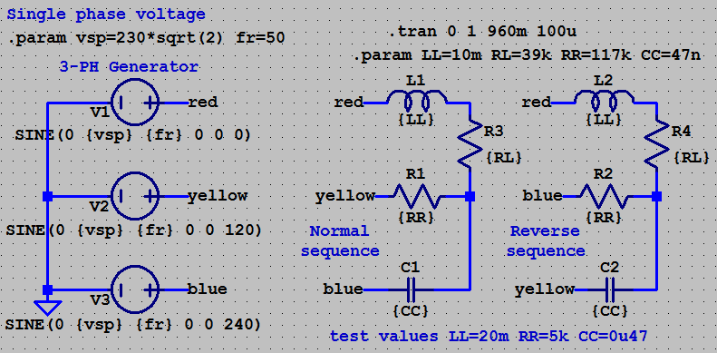

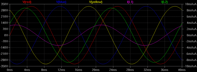

By summing the three 120° phasors through in phase R, delayed L and advanced C paths, the sequence will influence the relay current.
Here is an LTspice simulation. The three-phase supply voltage is plotted in red, blue and yellow, scale on the left. The relay current is plotted in magenta for normal sequence, green for reversed sequence, scale on right.
This is a primitive sequence detector. I do not know why they put the resistor in series with the relay. If the inductance of the AC relay had been used to delay relay current, then double the sequence discrimination should be possible.
As it is, the AC current needed to pull-in the relay flows continuously, yet it is only needed once, when the equipment is first turned on. That explains the cooking of the phenolic PCB.
The components used look reliable and should not fail. But there are much more reliable sequence discriminators available. If it fails to operate correctly when the sequence is reversed, then replace it with a new digital module.
https://www.ebay.com.au/itm/174535260665?
@ Baluncore; You hit the nail on the head for this issue, the LTspice simulation tells it all.
