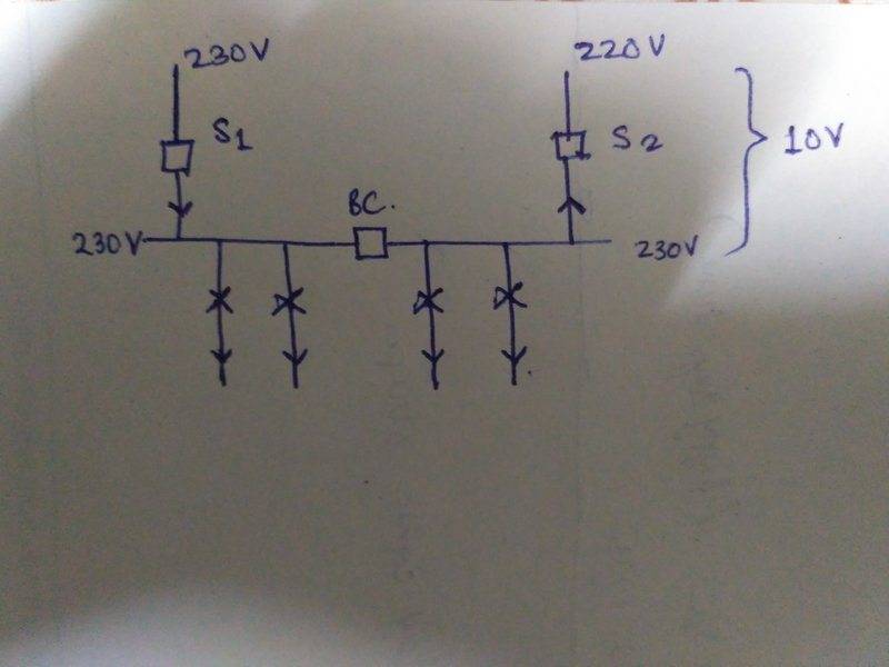

Oh thanks for the update.
So if two different sources energise the bus, the source at a lower voltage will draw current instead of actually acting as a source, though the amount of current would be proportional to the voltage difference.
Single-line diagram of two AC sources feeding a bus at 230 V through switches S1 and S2, with a bus coupler BC between them and four feeders, one with a 220 V label and a 10 V difference bracket.
I think this will be the correct representation of the system.
Let's consider a situation in which the sum of feeder current is say 100A. If the voltage sources were identical, then this load would have been shared as 50A for each source. In our system, what will be the distribution?
Will it be entirely supplied by source 1 (including the current that source 2 draws) from the bus?

Briefly,
There are impedances in the feeds to your bus. Current flow will be in strict accordance with the laws of Kirchoff and Ohm. You should be familiar with phasor notation to really enjoy them though.
A transformer has impedance so its output voltage drops (usually) a bit when current increases.
Impedance is usually given not in ohms but in "Per Unit" expressed as % . Let's just say 10%, it'll be given on the transformer nameplate.
All that means is that in changing current from no load to full load, the voltage drop across the transformer's impedance will reduce its output voltage by 10%.
So your bus will receive current from its sources according to their voltages and respective impedances.

Indeed currents can and do circulate.
In our two unit control room raising excitation on one machine changes current in the other one by circulating current out through the switchyard.
Same thing applies to the whole system, changing excitation in Miami affects generators in West Palm Beach. So the system dispatchers request plant operators to adjust voltage so as to keep the system in harmonious balance.

Per Unit is confusing at first. But it SOOO simplifies calculations that it's universally used.
It really is as easy as i said - a 5% transformer at 100% load will experience a 5% voltage drop. You don't have to convert to amps and ohms and volts .
Similarly a 5% transformer with a short circuited secondary will deliver 20X full load fault current .
