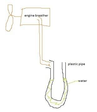

dear all,
some literature which I'm read, measuring blow by of engine can be execute use the pipe. not use with pressure gauge. how to measuring and calculating this if we must be use by pipe (not by pressure gauge)...?
here is the ilustration...(attach)
rgrds
=wahyudi.jr=
We measure the pressure drop over an orifice plate.
Your device isn't going to work; it's just going to blow bubbles, or blow water right up the spout depending on how heavily your engine is breathing.
If you must use a manometer, why not use a normal orifice plate and measure the pressure drop using an inclined manometer or some such?
It doesn't matter how the manometer is designed, its just not going to work. The slowest you will get a normal IC engine to run is maybe at around 300 rpm. Thats five pressure fluctuations a second. Manometers are fine for steady state measurements but no manometer will have a response fast enough for something like this.
That is a crankcase pressure tester. You place it in the dipstick tube, and if pressure is too high, there may be something wrong. It will not tell you which cylinder has the problem. For that you need to do a static and dynamic compression test. It can find other problems.

dear all...
thanks for replay, I'm sorry because my ilustration picture is uncorrectly.
here is we attach the ilustration again...
best rgrds
=wahyudi.jr=

Topher, it's not about measuring blowby of an individual cycle, but for the while engine.
Wahyudi, see my first post. Your design will give you crankcase pressure, but to measure blowby you need a flow rate. As I stated in my first post, you can do this by measuring pressure differential over a restriction.

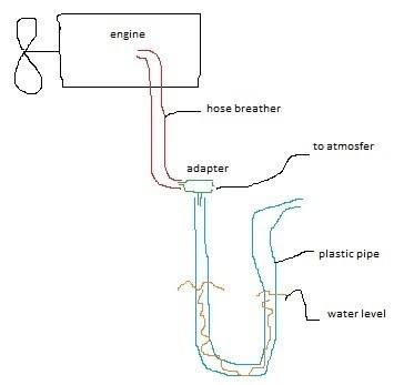

dear all...
here is my 3rd ilustration. which one the method to measure blow-by/crankcase pressure are correctly?? the 'A' picture or the 'B' picture ilustration.
note: - in Komatsu standard manual of engine, method 'B' is used
- in other reference, which I see...method 'A' is used
- so, which one the method are correct?
we wait U'r suggest...thnks

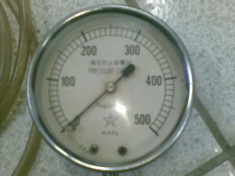

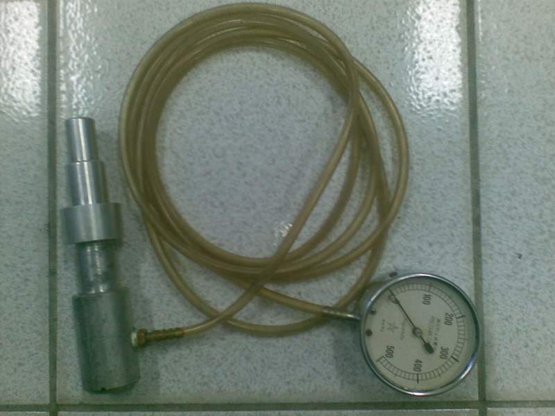

Mr...why I ask this case? because sometimes if we on job site there haven't a gauge, we usually use plastic pipe to read the blowby/crankcase pressure. but, the problem is how to read the movement of water level are correct? the 'A' one or the 'B' one on my 3rd ilustration above?
here we upload the tools if we use gauge...
rgrds
wahyudi.jr
So your question is "how do you read a U-tube manometer"?
Just measure from one meniscus to the other, that gives you liquid gauge pressure. Add barometric pressure for absolute.
Please still note that "blowby" is volumetric flow rate, you're actually measuring crankcase pressure. It's semantics but it's important...
Looking at your drawing you need to be careful where your "adapter" is; because there is movement of gas between the sump and atmosphere you might (is your gauge is right at the exit of the breather system) just end up measuring atmospheric pressure.

B, as I described, assuming I interpret your drawing correctly. And it doesn't measure blow-by, it measures pressure at the point the feed for the manometer is taken (which could be meaningless depending on its location). For the third and final time, blowby is a volume flow rate (measured in litres per minute, millilitres per second, or cubic yards per fortnight), you're measuring a pressure (bar, kPa, mmH2O etc).
ok Mr brewnog...
but, why not 'A' sir? what is the reason?
because, the ilustration 'A' is a simple measurement than 'B'
and THE MOVEMENT OF WATER IS ONLY FROM THE 1ST WATER LEVEL
TO 2ND WATER LEVEL.
why the measured object is like in the picture 'B' (the parameter value is from 2nd water level (left side tube) to the peak of water level in U-tube (right side tube)/while the engine running in rated speed)??
note: - if we calculate in mathematic, {mmH2O in 'B' = 2 x mmH2O in 'A'}
why not the mmH2O in 'A' we're use to the standart value? so we must not to
multiply the mmH2O in 'A' with '2'...give me a reason please..
thnks, rgrds
wahyudi.jr
Because you haven't stated that the "first" water level in A is just under barometric pressure. For all I knew it could be with the engine running at part load, in which case just measuring the delta from the "first" level would have been meaningless.

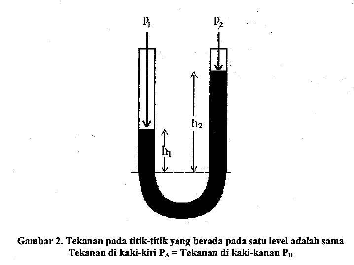

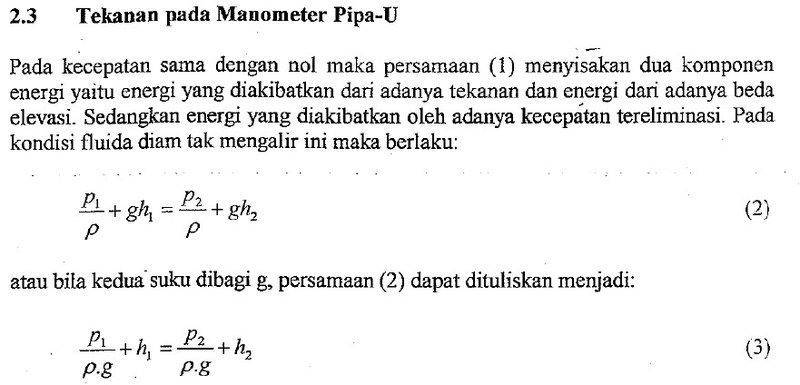

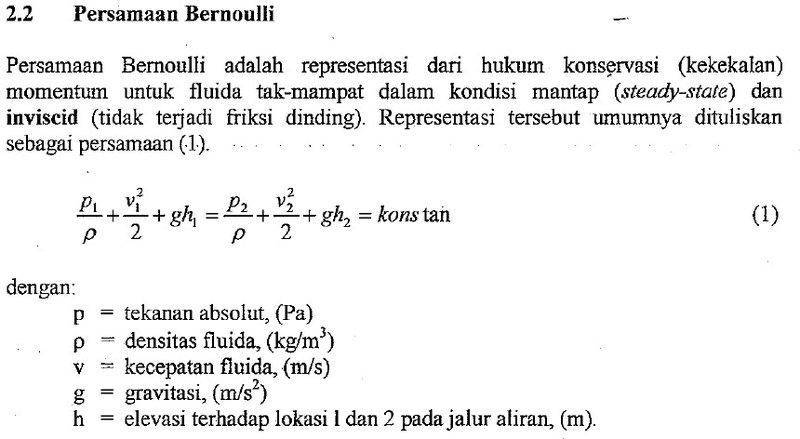

dear all...
thnks for advice me. some literature which I read on this page (informed by all),
here is my conclusion :
1. measuring blow-by/crankcase pressure can be use the basic principle of Bernoulli equation,
where this applicated to manometer system
P1 + h1 = P2 + h2...(where the gravity & density of the water is be ignored
because the value of gravity & density in the equation is same)
2. the pressure of blowby which we measure is SAME with the differential pressure between
P1 and P2
then,
P1 - P2 = h2 - h1 ...(h2-h1 = delta h/difference of height)
3. thus, the higher the pressure difference between P1 and P2, the difference in height
(h2 - h1) will be greater.
4. so, the pressure of blow-by is not indicated by how much water movement, but is shown
by how big the difference in height on the pipe surface water manometer.
here we upload my referance...
ok guys, thanks for a good disscuss...
best regards
wahyudi.jr
