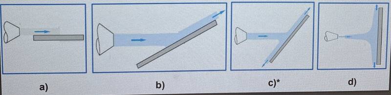

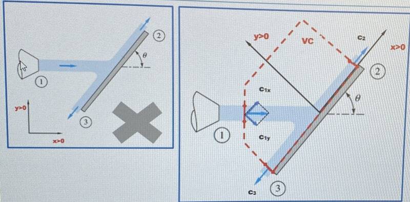

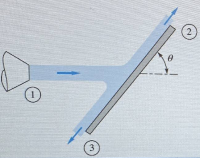

A two-dimensional jet of ##10\, \textrm{cm}## height sprays water at ##10\, \textrm{m}/\textrm{s}## which impacts, without friction, on an inclined plate...
DATA: ##\rho =1000\, \textrm{kg}/\textrm{m}^3##, ##c_1=10\, \textrm{m}/\textrm{s}##, ##h_1=10\, \textrm{cm}=0,10\, \textrm{m}##
Working hypothesis
- Stationary regime
- Uniform properties
- Incompressible flow
Continuity equation, Bernoulli equation
I was looking at an example of fluid mechanics and I don't understand this.
Statement figures:

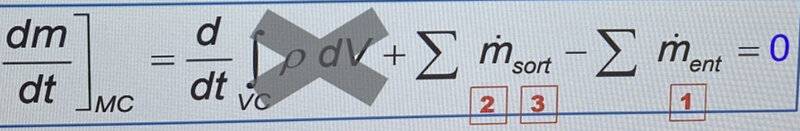

CONTINUITY EQUATION
$$\left. \dfrac{dm}{dt}\right]_{MC}=(\dot{m}_2+\dot{m}_3)-\dot{m}_1=0$$
$$\dot{m}_1=\dot{m}_2+\dot{m}_3$$
$$\rho c_1A_1=\rho c_2A_2+\rho c_3A_3$$
$$\rho c_1 h1=\rho c_2 a1+\rho c_3 b1 \rightarrow \textrm{unit width}$$
$$\boxed{c_1h=c_2a+c_3b}$$

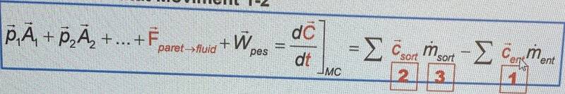

Equation Quantity Movement 1-2
$$\overrightarrow{F}_{\textrm{paret}\rightarrow \textrm{fluid}}=(\overrightarrow{c}_2\dot{m}_2+\overrightarrow{c}_3\dot{m}_3)-\overrightarrow{c}_1\dot{m}_1$$
x-axis
$$F_{p\rightarrow f(x)}=c_{2x}\rho c_{2x}A_2+(-)c_{3x}\rho c_{3x}A_3-c_{1x}\rho c_{1x}A_1$$
$$F_{p\rightarrow f(x)}=c^2\rho 1[a-b\cos (\alpha)h]=\tau A=0\rightarrow \textrm{Frictionless}$$
$$\cos (\alpha)h=a-b$$
y-axis
$$F_{p\rightarrow f(y)}=c_{2y}\rho c_{2y}A_2+c_{3y}\rho c_{3y}A_3-(-)c_{1y}\rho c_{1y}A_1$$
$$F_{p\rightarrow f(y)}=c^2\rho h\sin (\alpha)$$

$$\alpha :=\dfrac{45\pi}{180}=0.785$$
$$h:=0.1$$
We solve the system for ##a## and ##b##:
$$(0.08536,0.01464)$$
$$\rho := 1000$$
$$c1:=10$$
$$Fpfz:=\rho \cdot c1^2\cdot h\cdot \sin (\alpha)=7071\, \textrm{N}$$

So how do you find this ##\alpha## thing?
The fluid wall is the force that the wall exerts on the fluid.
So as there is no friction, I understand that there is not enough tangential force and therefore it is zero.
But then that angle ##\alpha## I don't know what it is and how you find it.

##a = b## if ##c_1 = c_2 =c_3##. That is a necessity under the assumption of incompressible flow (continuity).
That is how you get ##0## on the LHS for that direction. The momentum of each stream cancels, and there are no other external forces.

You have two directions to apply the momentum equation. You have only computed the following:
$$ \sum F_x = \cancel{ \frac{d}{dt} \int_{cv} v_x \rho d V\llap{-} }^0 + \sum \dot m_o v_{o_x} - \sum \dot m_i v_{i_x} = 0$$
You need to compute the momentum equation for the ##y## direction.

Yes, that's why you have to do the finding ##\alpha## thing.
And I don't know where you get ##\dfrac{45\pi}{180}##.
When you say ##\alpha## you mean ##\theta## as labeled in the diagrams?
That's what I don't know, this is what appears in the notes.
I suppose so.
Yeah, I've got to be honest. I'm coming up short on producing a solution for ##N## without the variable ##\theta## (the angle of the vane).
Your, "notes" imply it's a ##45^{\circ} ## angle. I don't think they solved for that.
Where does it say it is ##45##?
Where do we use it I mean
You notes say ##\frac{45 \pi}{180}## that is a ## 45^{\circ}## in radians?
You need ##\theta## it to find the normal force acting on the jet from the vane...unless I'm missing something.
It arises from simultaneously solving the momentum equations in each direction.
I don't know, it doesn't explain anything well.
The normal force is:
$$ N = \rho A_1 c^2 \sin \theta$$
