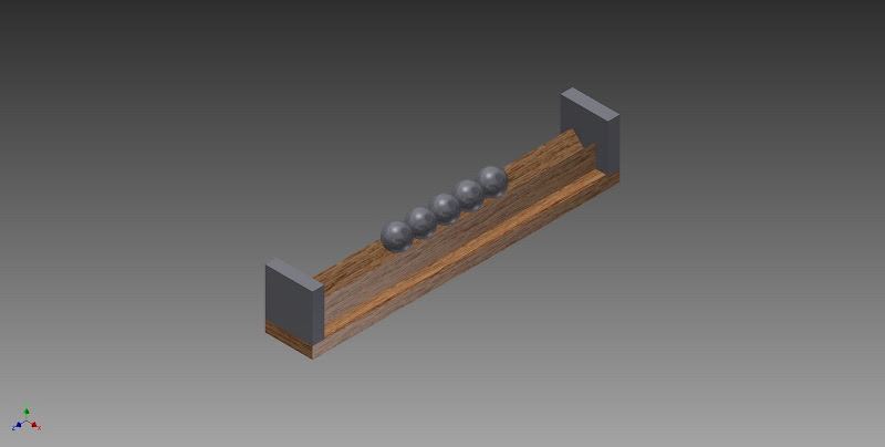

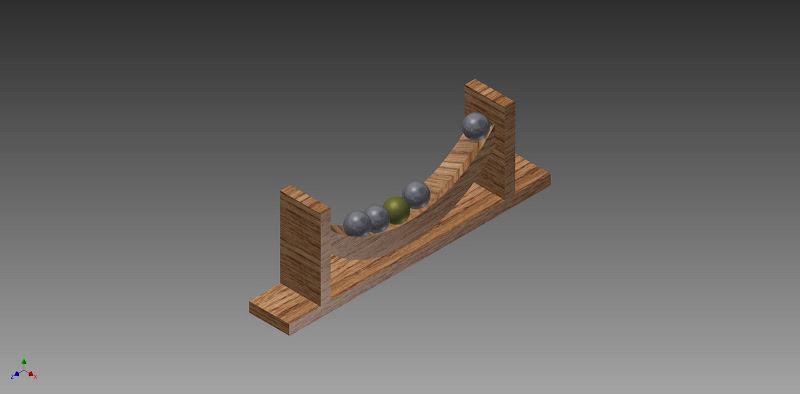

I would say it's a theoretical possibility but not a practical one.
Newton's cradle works because the system has almost zero loss, the spheres hold enough energy that the losses on impact and through air resistance are relatively insignificant.
If you translate the mechanism into say balls rolling in a parabolic wooden channel, the friction losses would 'kill' the motion rapidly.
Then, the diamagnetic effect is weak - very,very weak - unless you have a superconductor - and so it's unlikely to act well on a heavy sphere. But a light sphere won't hold enough kinetic energy for the motion to sustain for long against friction losses.

Here is the original concept.
Are there any ways (at all) to make this function "forever"? (and by forever I mean for a long time, similar to a Newton's Cradle.) I don't care about the power source, whether it be magnets, physics, or whatever. I am open to any and all solutions.
Thanks for any help.

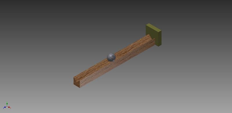

Basically, if I fix a neodymium magnet in the middle of a ramp, have a ball attached on one side, then drop a sphere from the other side, can I not create an effect in which the second sphere is fired, stops because of the slope, and make it come back and create an equal effect back in the other direction? Thus creating "perpetual motion?"
Pictures to follow. Share your thoughts.
Neodymium magnets are too strong for this as when they hit each other the force is so great that small deformation will occur at the contact piont. That is another loss to ad. Plus that magnets are slowed down by any metal in close proximity, so tricky usable materials (Plastic is a sad material for a desk toy).
Well so the magnet deteriorates. It will still last a long time, and its more just a cool thing to put in motion when I feel the desire to.
Also the base will be designed out of wood, not plastic, so...
Pics to come soon
EDIT: And here it is.
Furthest ball dropped, 'Gauss' occurs, closest ball goes up ramp, then comes back down, more 'Gauss' occurs, and furthest ball is flung back up again. And that's all with only gravity and magnets.

I'm not talking about long lasting magnets, i want to tell you that by using magnets you add more loss to the system as they deform so the long-lasting motion in Newtons cradle won't be that long in your case.
The last CAD (is it SolidW?)pic has a nice ideea but inevitably there will be some friction between balls and wood =)). Again the motion won't last that long.
My thought is that if the Gauss effect happens once, then speed will instantly be gained. Then the sphere will reach the top of the arch, and get renewed with the same amount of energy as it originally had on the other side. This renewal of energy should be permanent.
And if any deterioration occurs, it would happen between the two outer ball bearings and the ball bearings they touch. If you have ever seen a Gauss Cannon function, you would know what I mean.
