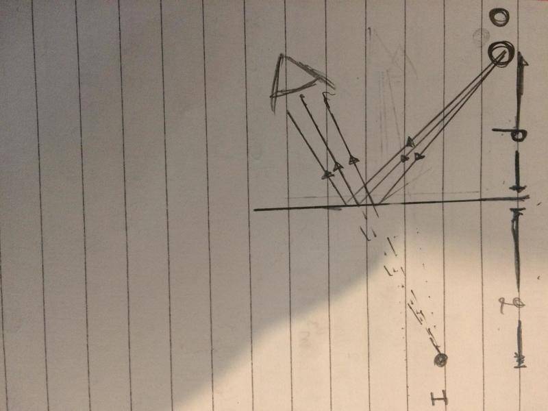

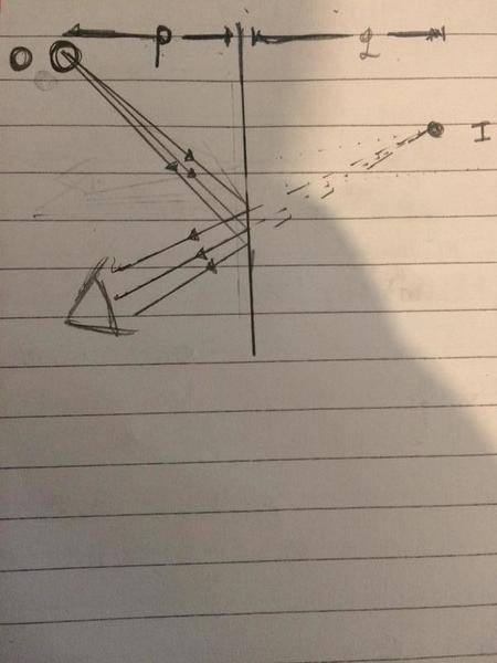

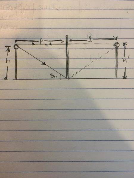

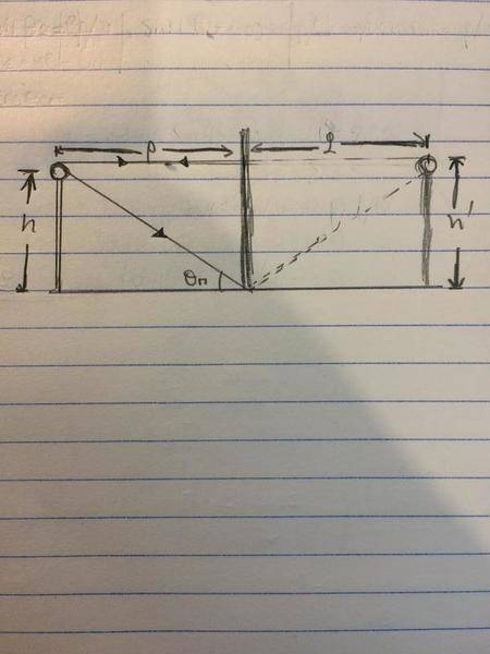

Find the minimum height of a vertical flat reflector, in which a 1,78 m person can see its full reflection.
M = h'/h
I really don't know what to do here, and I feel as if I'm missing some crucial element. The chapter about vertical reflectors is very small (3 pages or so) and really has no other exercises besides a theoretical one based on this design:
I tried going at it by creating "formulas" with the different angles, but nothing really worked. I assume the hidden detail is in that the person can see its full reflection, but other than h = h', I'm not saying anything else. It might be an issue in translation as well.
Any help is appreciated!

I do not understand the diagram.
My interpretation of the question is that you are to mount a mirror vertically on the wall such that a 1,78m person standing in front of it will see their whole reflection. The length of the mirror is to be minimised.
That does not look at all like your diagram.

Well, in that particular "chapter" (O2.1 of Serway's Physics, 8th Ed, Vol 2) that's the only instance it deals with. The person is on the far left, and the reflector/mirror is vertical to the floor (with the reflection on the far right). Pretty much this:

Ok, so draw a side view showing the light paths to the eye from the extremes of the body.

That's what I have on my first post is supposed to be. I did it according to the book's orders: One ray of light is perpendicular to the reflector, and parallel to the ground. It hits the reflective surface, and returns back to the person, following the exact same path. The other ray of light follows a diagonal path, and is reflected by the surface, thus creating the prolapse/reflection angles. If we "continue" the rays, they meet at some point, and thus we can "draw" the (imaginary) reflection with height h'.

My eyes are not quite at the top of my head.

Neither do my eyes emit light. The light comes from what I am looking at. If I am looking at my feet in the mirror, what path do the rays take?

Yeah, I know it's not exactly a model that represents the physical world, but that's the only example/exercise the book has. You are supposed to act as if the object/person/source of light are one and the same.
What I'm guessing you mean is something like this, right?

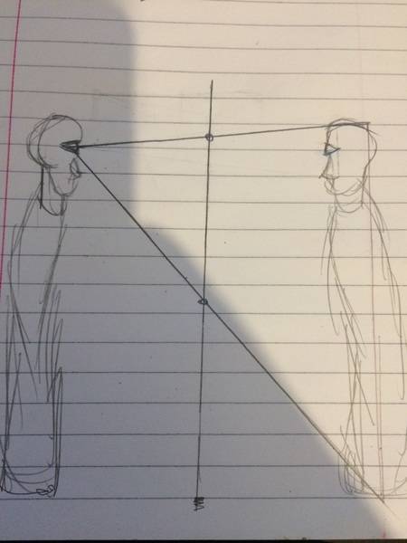

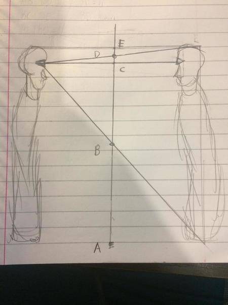

Well, in that case, I guess this is the diagram:
a9cDlwF1jEaal_B3vh590m2jlILW9UOICxI.&token=5ea04c16-2036-4536-ae23-ba56c41cb911&owa=outlook.live.jpg
Great.

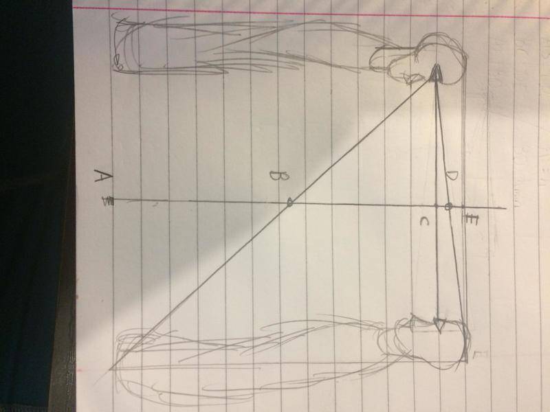

Add one more line, the horizontal joining the two sets of eyes.
Define some points on the mirror vertical:
A at ground level, B where the lower ray crosses, C at eye level, D where the upper ray crosses, E at scalp level.
What is the relationship between the following pairs of lengths:
AB and BC
CD and DE
AE and h, the height of the viewer
AE and BD?
Which length is the minimum length of the mirror?

Updated sketch:
In this case, AE is the height, h. BD is the minimum height of the mirror, hmin, which is what I'm trying to find. As for the rest, I'm not seeing the connections between them. They probably have something to do with the similar triangles, but like I said, geometry is really not my strong suit, so I'm at a loss.

Well, I think I finally did it.
I looked at the two triangles above the eye-to-eye horizontal, and go with SAS, I found out they're congruent, so CD = DE. Same with the ones ellow the horizontal, so AB = BC. So:
AE = AB + BC + CD + DE = 2BC + 2CD = 2BD <=> hmin = h/2
I'm not sure if that's entirely correct, but this is purely a geometry issue. Either way, thanks a ton for the help and patience everyone!
It is.
