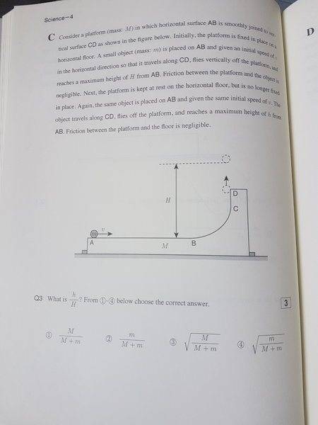

Diagram of a small object on a platform with a curved ramp: horizontal surface AB, curved section BC, vertical wall CD, with height H marked from AB to a dashed trajectory above D, and labels A, B, C, D, M and v.
Consider a platform (mass: M) which horizontal surface AB s smoothly joined to vertical surface CD as shown in the figure below. Initially, the platform is fixed in place on a horizontal floor. A small object (mass: m) is placed on AB and given an initial speed of v in the horizontal direction so that it travels along CD, flies vertically off the platform, and reaches a maximum height of H from AB. Friction between the platform and the object is negligible. Next, the platform is kept at rest on the horizontal floor, but is no longer fixed in place. Again, the same object is placed on AB and given the same initial speed of v. The object travels along CD, floes off platform, and reaches a maximum height of from AB. Friction between the platform and the floor is negligible.
What is h/H?
K1 + U1 = K2 + U2
So I got H form
½ mv^2 + 0 = 0 + mgH
H = v1^2/2g
However I'm not sure on how to get h.
I do know that some of the kinetic energy is transferred to the platform and also momentum should be conserved.

Momentum is conserved in the second case, where the platform is free to move. You use momentum conservation to get the velocity of the platform after the small object has interacted with it. All the momentum of the small object is transferred to the platform. This gives you the velocity, and kinetic energy, of the platform. The remaining energy goes into the upward motion of the small object.

Careful. For the second case, the final horizontal component of velocity of the small object is not zero.

What do you learn from conservation of momentum?
How does the final horizontal component of velocity of the small object compare to the final velocity of the ramp? Hint: Section CD is vertical.
I see that the platform curve is vertical where the small object exits. That is why I said all the (horizontal) momentum is transferred to the platform. Was I mistaken?

When the small object leaves the ramp at point D, it is moving vertically with respect to the ramp but not with respect to the ground. So, the small object does not lose all of its horizontal momentum with respect to the ground.
