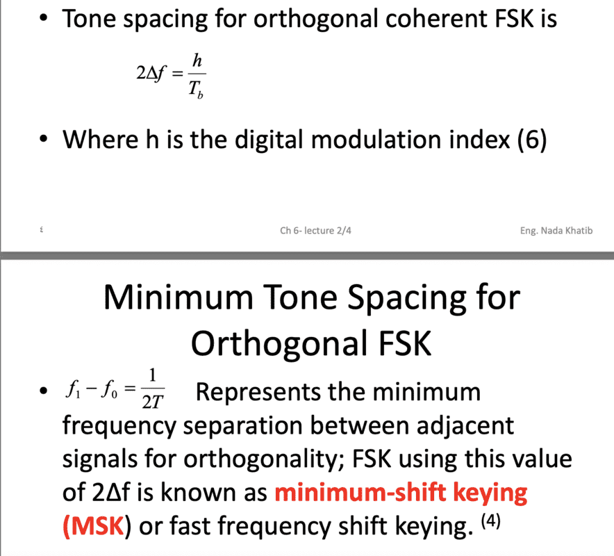

What is the reasoning behind the minimum tone spacing for coherent FSK?
Hi,
I was reading through some online notes and was wondering: when dealing with coherent FSK, what is the minimum tone spacing and why?
I know that for non-coherent FSK, we can show that the minimum is: ## f_1 - f_0 = \frac{1}{T} ## where ## T ## is the symbol period. However, if we are now dealing with coherent FSK, how can I go about finding the minimum difference required (which will help me find the bandwidth)?
After a quick google search, the only reference I could find to the topic was in some online lecture notes (shown in picture below) which just simply stated that ## f_1 - f_0 = \frac{1}{2T} ## for the minimum without any explanation. I think I must be overlooking something quite obvious. What would be a good starting point for me to be able to derive/understand this property?
Thanks in advance for any help.

Tom.G said:
I was hoping someone would be of more help than I can. Anyhow, here is what I found.
Rather heavy on the math, not a beginners article:
https://www.dsprelated.com/showarticle/1016.php
That and others found with:
https://www.google.com/search?&q=minimum+shift+keying+tutorial
Good Luck!
Tom
Thanks @Tom.G !
That link with the maths basically answers the question perfectly! However, I think one question I have is: what do coherent and non-coherent mean?
When we do that integration orthogonality proof for non-coherent signals, there is a phase off-set ## \phi ##, as well as a difference in frequency, between the two signals - that is we have ## cos(2 \pi f_0 t) ## and ## cos(2 \pi f_1 t + \phi) ##. However, for coherent this is not the case - why is this?
Does that just follow from the definition of the terms? I read that we can think about coherent signals as coming from the same source, whereas non-coherent is when they come from different sources. Therefore, we assign an arbitrary phase difference ## \phi ## to account for phase differences between the two signals. Is this heading towards the right direction?
That is my (non-expert) understanding.
