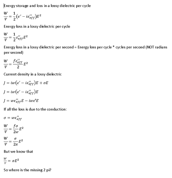

Missing factor of 2 pi in dielectric loss?
The discussion centers on a misunderstanding regarding the dielectric loss formula presented in the document referenced, specifically in section 1.14.5. The contributor highlights a discrepancy involving a missing factor of 2π in the right-hand side (RHS) of the formula. This indicates a need for clarity in the application of the formula to accurately represent dielectric loss in materials. The contributor acknowledges their learning process and seeks further explanation to resolve the confusion.

Hi. I am sure that this is something to do with it being Friday afternoon...but can anyone explain what I am missing here?
Thanks. Yes, I see that my sums merely had the superficial appearance of reality!
