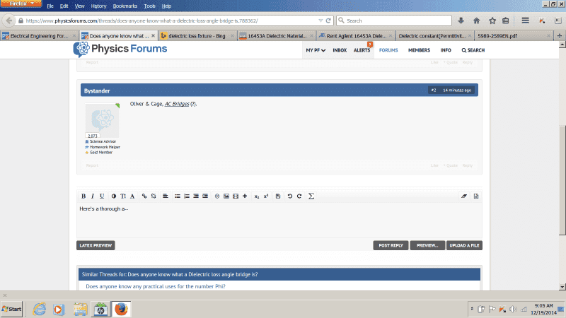

I'm not sure what the significance of the .png 's were but the 'keysight' link didn't work. I'll look at the:

I don't know how those png's got there!
