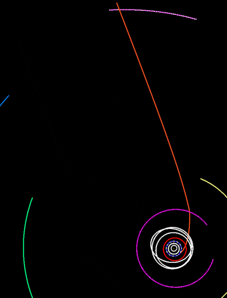

Here's a diagram showing how Jupiter bends the trajectory of New Horizons. Relative to Jupiter, the inward and outward velocities are the same, but relative to the Sun, they are not.
Color code:
Sun: yellow dot
Mercury: gray
Venus: white
Earth/Moon : blue/gray
Mars: red
Ceres, Pallas, Vesta: white
Jupiter: purple
Saturn: yellow
Uranus: green
Neptune: blue
Pluto/Charon: purple/white
New Horizons: orange
