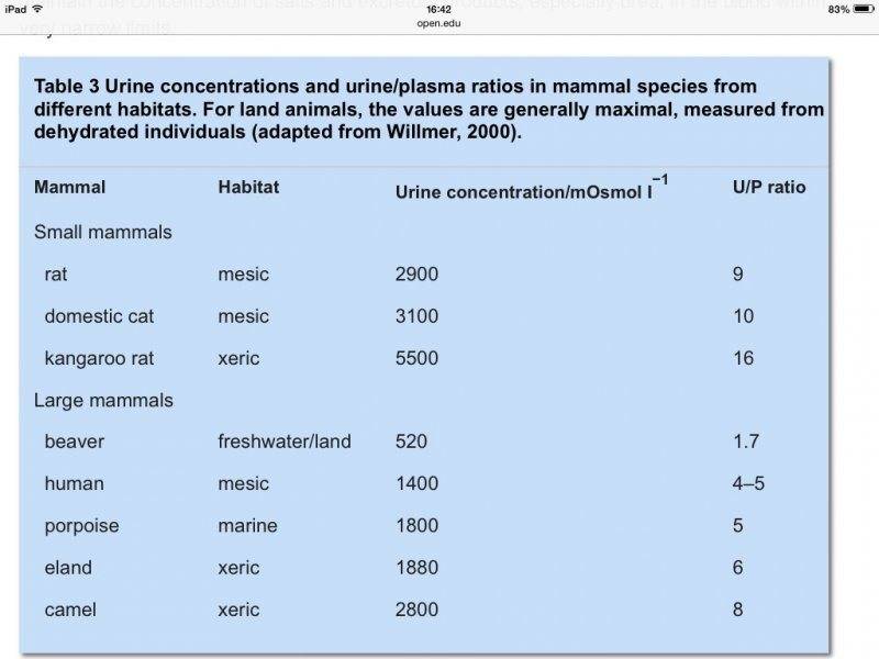

The concentration of urea in cat urine was asked. It is a generalisation that urea is more concentrated in most terrestrial mammals than in humans. It would take some time to assemble data. See attached table ref http://www.open.edu/openlearn/natur...es-the-desert-environment/content-section-3.2 However the figure quoted there for humans is quite a lot larger than I have seem elsewhere and I think it can be a fraction of molar. Cat I have seen can attain 5M. This relatively poor water economy in humans has long been one element in the speculation that our ancestors passed at least a period of time somewhere where fresh water availability was not a limiting problem for them, for which I think there is more recent evidence. We are not in such conditions now in most places!
