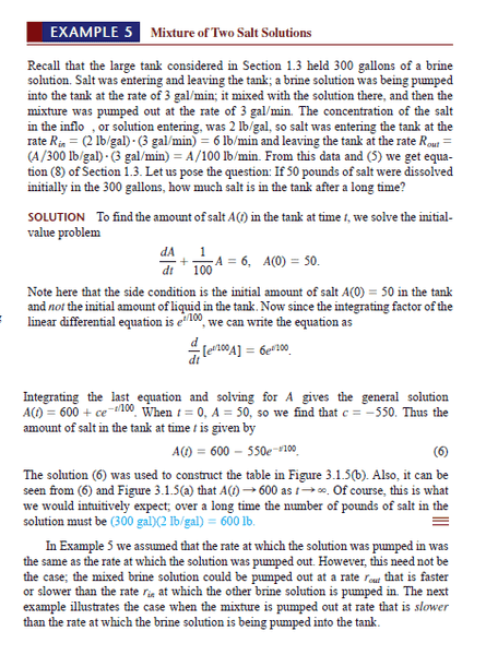

I need to solve for C. I know it's probably simple but i don't remember how to. This is what I have so far:
Because the volume flow rate entering is different from the volume flow rate leaving, you need to write down two differential equations, rather than 1:
Volume Input - Volume Output = accumulation for the volume of fluid in the tank
Chemical X Input - chemical X Output = accumulation for chemical X in the tank
If V(t) is the volume of fluid in the tank at time t, fin is the volumetric flow rate of fluid in, and f_out is the volumetric flow rate of fluid out, what is the differential equation for V?
If C(t) is the concentration of chemical X within the tank at time t, and C_in is the concentration of chemical X in the feed to the tank, what is the differential equation for the rate of change of total chemical X in the tank?
The next step is to multiply the differential equation for V by C, and subtract the resulting relationship from the mass balance on chemical X.
I don't follow.. The way I did it is the way the professor instructed us and the steps match the steps in his example. To solve for C, I now realize from an example in the book that A(0)=35. With that information, I can solve for C.
OK. I see what you did, and, of course, it is right. But, here's my alternate version to consider:
\frac{dV}{dt}=f_{in}-f_{out}
\frac{d(VC)}{dt}=f_{in}C_{in}-f_{out}C
Multiply the first equation by C and subtract it from the second equation:
V\frac{dC}{dt}=f_{in}(C_{in}-C)
where V=V_0+(f_{in}-f_{out})t
So,
\frac{dC}{(C_{in}-C)}=f_{in}\frac{dt}{V_0+(f_{in}-f_{out})t}
