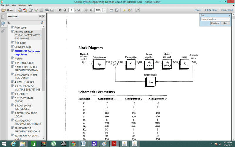

Listed under 2.1 in the image above.
This is the only relevant equation that I'm aware of, but I'm almost sure that there is something else I need to know before I can solve the problem.
I tried solving for the preamplifier first, then I realized I was just running around in circles and not actually solving anything.In order to get V_e(s), I need to first find the output of the first potentiometer and subtract it from that of the second one.
output for first potentiometer: K_pot*θ_i(s)
output for second potentiometer: K_pot*θ_a(s)
V_e(s) = K_pot(θ_i(s)-θ_a(s))
Now, V_p(s) = K*V_e(s) = K*K_pot(θ_i(s)-θ_a(s))
Transfer function of preamplifier: [K*K_pot(θ_i(s)-θ_a(s))]/[K_pot(θ_i(s)-θ_a(s))] = K
Clearly the transfer function is not the same thing as the function for the physical block, so I must be doing something wrong here. I just don't see how I can fill out the table using just the equation I was given.

it looks like you have a fundamental misunderstanding of what transfer function you are solving for.
K is typically a fixed value that you choose (using a technique like root locus for example)
When you are told you need to sole for a transfer function, typically you solve for the output over the input (azimuth angle over desired azimuth angle). so your transfer function for the preamp would simply be K
there are many ways to do that. two simple ways are the mason gain formula and simple block diagram algebra.
https://en.wikipedia.org/wiki/Mason's_gain_formula you can follow this if you want to do masons gain
block diagram algebra for a problem like this is simple:
V_e=V_i-theta_o*K_pot_2 ...as you already mentioned
simply multiply that by the forward chain until you get to your output. then manipulate the equation so you have your output over your input

I must admit that I do not completely understand the problem:
1.) All the transfer functions of the variuous blocks are given in the Block diagram
2.) Where is Block 6 (integrator)?
3.) As far as I understand, you are required (according to 2.1) to derive the "open-loop transfer function".. That is the transfer function between input and output WITHOUT any feedback. Hence, it is simply the product of the shown 5 Blocks in the forward path.
So - what is the problem?
