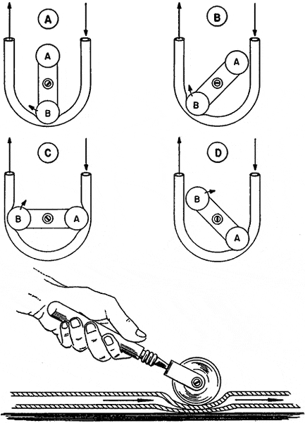

I would want to model a blood roller pump - a simple peristaltic pump. I was wondering, what kind of formulas there are that I can use to model a pump which optimizes the number of rollers, roller diameter, tube diameter etc. Naturally I would have to constrain these parameters, the problem is I don't know what kind of formulas I would use. Any help behind the physics of a blood roller pump would be appreciated!

I wasn't thinking anything too complicated.
What I want to test is how to optimize the flow (I would want to achieve the highest flow while retaining constant output pressure)
Taken that I place my 'rollers' a certain distance from the center of roller head and the tube I would like to examine how by changing roller diameter the flow would change. I expect the flow to be the best when the tube gets completely occluded but I would also love to see how it behaves in semi-occluded states. Same would be for the tube diameter. If the length of the tube would remain constant, the higher the inner diameter - the higher the flow. These parameters (roller, tube diameter, rpm etc. in can create different combinations but I want to find out formulas to from which to derive the connection between these parameters).
The formula I have so far is Q=π*r2*l*rpm
where Q would be flow, r - inner diameter of the tube, l - contact length with the rollers (half of a circle)
What this formula doesn't give me is how flow would behave in semioccluded state. How would i go to find this?

For semi-occluded, you would need to factor in the input pressure and output pressure, I believe. But AFAIK, all medical peristaltic pumps rely on full occlusion. Otherwise their metering function would not work, and that is extremely important in medical applications. Also, the design of a high-flow pump for cardiac bypass operations will likely be different from what you use for IV infusions, right? Are you modeling both of those applications?

A semi-occluded tube in an IV infusion pump would be disaster. You need to be able to precisely meter the flow. The pressure can vary slightly as each roller let's go at the output side of the pump -- that's no big deal medically.

To get almost constant pressure out of a peristaltic pump, you will need to use other than a constant angular velocity for the pump shaft. Can you say what you may have to do to mitigate the slight pulsing that you get at the output of a traditional peristaltic pump that uses a constant shaft rotation speed?
You might also clarify this with your instructor. AFAIK, normal medical peristaltic pumps use a constant output shaft rotation rate, set by the IV flow rate. They probably use microstepper motors anyway, so you will always get small pulses as a result of each microstep.
