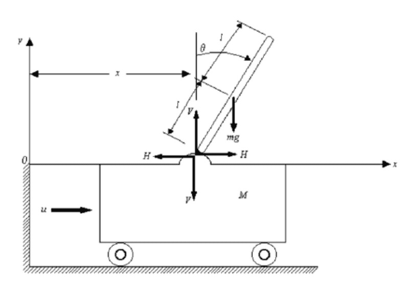

I'm trying to model an inverted pendulum attached to cart system with 2 propellers at the top of the pendulum. The 2 propellers are meant to be controlled by a controller (PID and pole placement) to keep the pendulum in an upright position. Impulse disturbances are applied to the cart both at the top of the pendulum as well as to the cart.
Hello so as the summary suggests I'm trying to develop a controls system model of an inverted pendulum cart system with 2 propellers on top of the pendulum. I'm trying to obtain the equations of motion and I was wondering if I should include the impulse disturbances forces when trying to develop the equation of motion of the system. I have an image below just missing the 2 propellers on top of the pendulum. Also any advice into designing the controller to better react to impulse disturbance is appreciated. Also my derivation skills aren't good so if there's any resources such as software (matlab or python) to help me derive the equation of motion, that would also be appreciated. Thank you

Matlab has a symbolic package, which can help with arranging formulas, when working on the derivations. I would create some free body diagrams to account for the forces and motions involved to start. An inverted pendulum can be balanced with just a moving cart. Once you have that solved then could try adding more complexity such as propellers.

Hello, I think I obtained the equations of motion of my system. I'm trying to perform pole placement control so for that I need to obtain the transfer function. But the problem is that the equations are very nasty and large so by hand is very difficult, would it also be possible to use Matlab to obtain the transfer function so I can use pole placement?
Thanks
Are you working with it in the time domain? If so, you'll need to perform a Laplace transform. I'm not sure how Maylab does that (it's been awhile) but they have help and a forum.
Also, you could use Maple or probably Mathematica to do this, as well.
