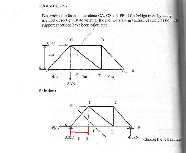

for moment about C, the author gave [-F_(FE)](5) +3.2(4) +6(5) = 0
i don't understand the working...Why there are moment 3.2(4) and also moment 6(5)?
for moment 3.2(4) , it's centered at F, so ,it's not moment about C ,am i right?
for moment 6(5) , it's moment about A, am i right?
[/B]
  • Solution diagram of a trapezoidal bridge truss with vertices A, C, D, B on top and bottom; 6kN applied at A, 3.2kN reaction at the left support, 8 kN load at F, 4.8kN reaction at B; dashed section line cuts members CF, CE and FE; labels 6, 8 and 4.8kN shown.
The author has isolated the bot left section in a free body diagram. In order to determine the force in FE, you need to sum moments about C because summing about A or B wil not allow solution of the FE force because the force action line passes through those joints. The 6(5) moment you talk about is the moment of the horizontal reaction force at A about C.
how about moment 3.2(4) ? it's moment about F,am i right? why the author included it into calculation?
Well it is a moment about F, but it also is a moment about C, which is the point of interest . Remenber that moment is force times perpendicular distance from line of action of that force to the point of interest.

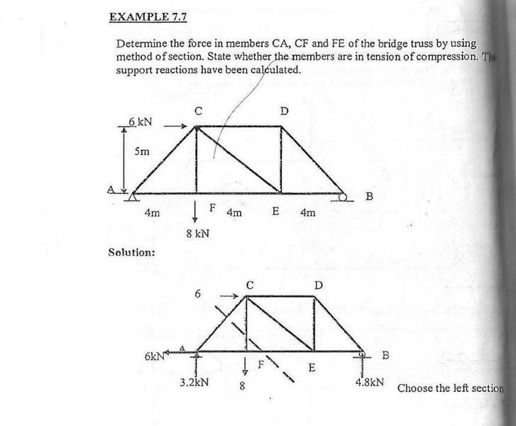

i still don't understand...
the perpendicular distance is the 4m(see red labelled part), it's span from F to A, so moment is about F, not C, am i right?
  • Truss diagram of a bridge with a worked solution, showing the left section cut through members CA, CF and FE, with forces 6 kN, 3.2 kN, 8 and 4.8 kN marked and a red horizontal dimension of 4 m between A and F.
The perpendicular distance from the line of action of the 3.2 kN force to C is also 4 m. Just extend the 3.2 kN force arrow straight up and measure the perp distance from that line to C. This is one of several methods to calculate moments.
but,the force 3.2kN is being applied at A, not 4m away from C, how can we dothat?
PhanthomJay said:
why not?
The force is not applied at C, but at A
you are not understanding how to calculate moments using perpendicular distances from the force line of action.
Now I just noticed the reactions are incorrectly calculated by the author, based on the dimensions and loads given. . You might want to find the correct vertical reaction at A by looking at the entire truss and summing moments about B and report your result.
