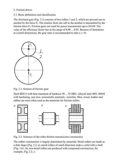

Two rotating cylinders are held in contact by a force F1. The force is applied through the center of one of the cylinders. One cylinder is the driving cylinder and the other is the driven cylinder .
Does the moment of inertia of the system depends on the force contact force F1? Why?

Both, F1 (the pressing force between rollers) and the tension of the belt, only put load on the bearings supporting the axles.
If excessive, that increases friction and heat, reducing effective transferred power.
The moment of inertia of the systems does not depend on those forces or friction.
It depends only on masses and their average distances to the axes of rotation of rollers or pulleys.
The inertia is only important for changes of rotational velocity, during the start up process.
For the pulleys for belts, you can reduce their moment of inertia by reducing diameter, but then, the belt must wrap and bend around a reduced radius, which increases internal friction and heat in the belt: again, wasting energy for as long as the mechanism is working.
Research frictional gears.
https://www.calameo.com/read/006229255137154b6ea2e
