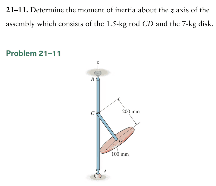

cherry
25
Determine the moment of inertia about the z axis of the assembly which consists of the 1.5-kg rod CD and the 7-kg disk.
I_zz=int(r_z^2)dm
I am not getting the right answer and I don't know where I am going wrong. Help would be appreciated, thanks!
(My apologies if my equations are not formatted correctly, I am still having trouble using LaTex on here)
My work:
\mathrm{I}_{zz}=[\frac{1}{12}(1.5)(0.2)^{2})+1.5(0.1sin(26.56))^{2}]+[\frac{1}{2}(7)(0.1)^{2}+7(0.2sin(26.56))^{2}]=0.09898{kg}\cdot{m^2}
Correct answer:
\mathrm{I}_{zz}=0.0915{kg}\cdot{m^2}
Are you considering the location of the rod's center of mass?

cherry said:
Homework Statement: Determine the moment of inertia about the z axis of the assembly which consists of the 1.5-kg rod CD and the 7-kg disk.
Relevant Equations: I_zz=int(r_z^2)dm
My work:
$$ \mathrm{I}_{zz}=[\frac{1}{12}(1.5)(0.2)^{2}) +1.5(0.1\sin(26.56))^{2}] +[\frac{1}{2}(7)(0.1)^{2}+7(0.2\sin(26.56))^{2}]=0.09898{kg}\cdot{m^2}$$
Correct answer:

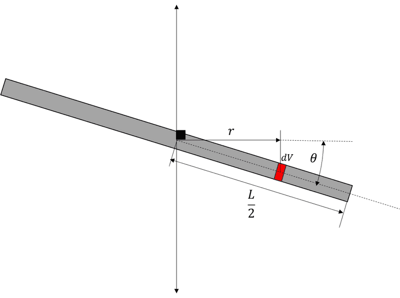

erobz said:
I think it would help you ( for starters) if you tried to derive the mass moment of inertia of a thin-rod about a vertical axis passing through its center at some angle ##\theta## from horizontal using the definition:
$$ I = \int_V \rho r^2 ~ dV $$
It's not easy to tell where you are going wrong without steps, thought process, and working equations in Latex... So lets just start from the beginning.
The center of mass of a thin rod is at L/2.
My derivation for the mass-moment of inertia of a thin rod about a vertical axis based on the diagram provided is the following (x is along the axis of the rod):
$$ \rho=\frac{m}{L} \longrightarrow dm=\frac{m}{L}dx $$
$$ I=\int_V{\rho r^2}dV $$
$$ I=\int_{0}^{L}\frac{m} {L}dx\cdot(xcos\theta)^2 $$
$$ =\frac{m}{L}cos^2\theta\int_{0}^{L}x^2dx $$
$$ =\frac{m}{L}cos^2\theta(\frac{1}{3}L^3) $$
$$ I=\frac{1}{3}mL^2cos^2\theta $$
Based on the question, theta ends up being:
$$ \\\theta=90-tan^{-1}(\frac{0.1}{0.2}) $$
$$ =90-26.565 $$
$$ \theta=63.43 $$
Please let me know if I'm on the right track! Thank you.

I was asking for a derivation about a central axis. Also, your element ##dV## doesn't seem to make sense. Neither do your limits of integration.
Just say the cross-sectional area of the element is ##A##, and the uniform density of the bar is ##\rho##, and they are both constant with respect to ##r##. Try again for the axis shown in the diagram.
Actually lets just take it piece by piece. What is ##dV## ( the volume of the differential element in red) in terms of ##dr##? Remember, ##r## is perpendicular to the axis of rotation. Just write me the integral (without limits), with the constants factored out.

So, ##\rho## isn't a linear density in the equation. ##dm = \rho dV##, so that was confusing for me. I also see that you have transformed to ##x## along the length of the bar instead of keeping with ##r##. Ok.
Your main issue here is that you have the limits of integration incorrect (as @Lnewqban is pointing out) for the axis in the diagram. You are unwittingly computing ##I## about an axis passing through the end of the bar. Which is what you have in your problem, but not what I asked.
