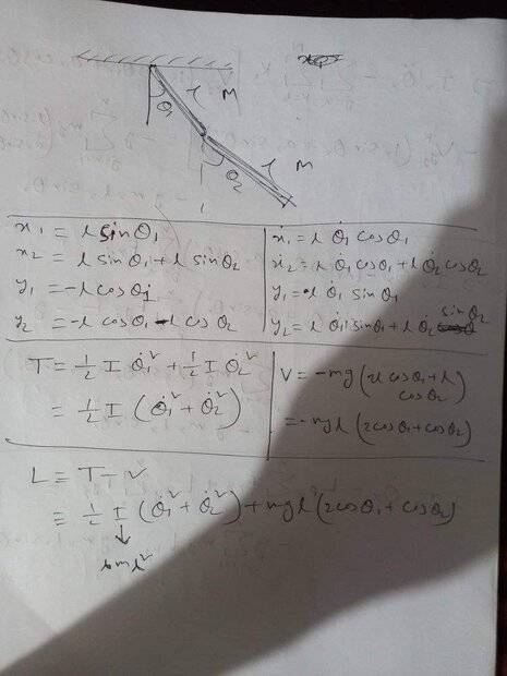

My task is to solve the equation of motion for a double "physical" pendulum!
L=T-V
$\tau=Fr=I\alpha
I am having trouble to find the moment of inertia of the second rod!
Is it related to the first rod??
At the beginning I thought It's not!
But when took those as constant,the equation had become way much simpler and there is nothing about chaos!
My approach is given below
Use the fact that the kinetic energy of either rod is the sum of two contributions:
(1) the kinetic energy due to the motion of the center of mass of the rod: ##\frac {1}{2} M V_{cm}^2 ##
(2) the kinetic energy due to rotation about the center of mass: ##\frac{1}{2} I_{cm} \omega^2##

The big problem here is the assumption that
T = \frac 12 (I_1\dot\theta_1^2 + I_2\dot\theta_2^2)
The kinetic energy cannot be written on this form. Note that the second rod will also move when ##\theta_1## changes.
Note: The angles are the angles each rod make with the vertical. This does not mean that the motion of rod 2 is independent of ##\theta_1##.
