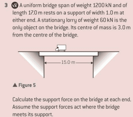

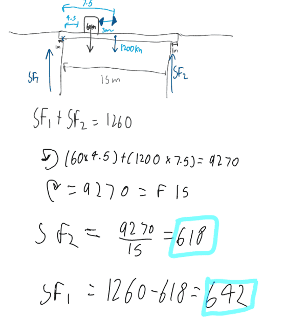

Hello! I was doing this question from a textbook and I am Unsure why my answer is slightly different to that of the textbook
M = Fd
SF1 + SF2 =SFT
The Question
What I did
The Answer

Some of the data is given to only 2 significant figures. So, the answers might be rounded to 2 significant figures.

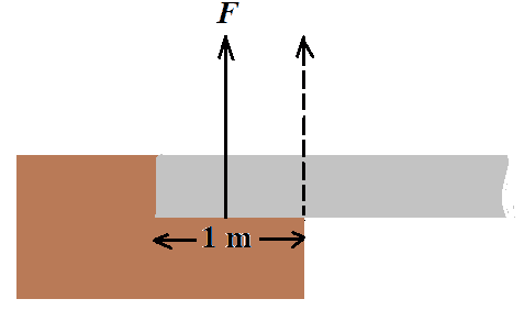

Also, the support forces at each end might be considered as acting in the middle of the 1-meter width rather than at the edge (dashed):
The problem states explicitly that the forces are assumed to act where the bridge meets the supports. I’d go with the rounding option.
Ah, thank you yep, I believe it is an SF error, Thanks again for the help everyone!
Yes, I overlooked the comment about the location of the forces. Thanks.
