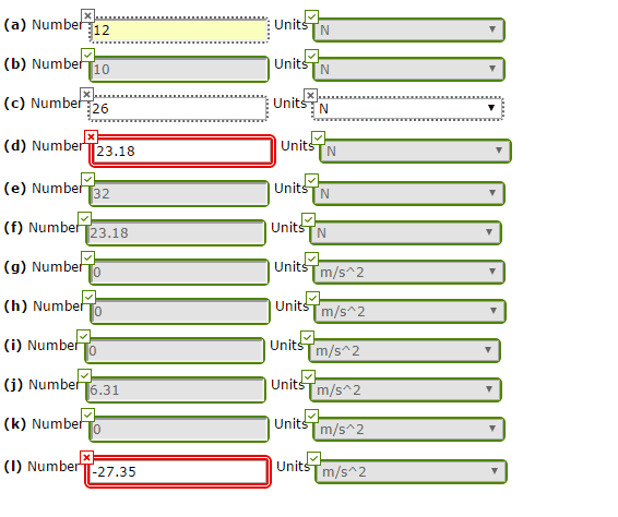

Hello, I have attached a physics problem that I solved yet some answers (in red+the first answer) are wrong and I can't find out why...

I got a wrong answer for c and i here's what i did:
for the c : sum of forces=0 which means P-W-f=0 ; 49-23=26 so f=26 but it is wrong
and for the i: a=sum of forces/m and m=W/9.8 I got -27.35 but it is wrong

The correct sign for up and down follows from b) which is counted as correct answer: + 10 N means 10 N up. Hence the cross at answer a, I assume.
What is the direction of the friction in (c) ? Which way is your f positive ?
I expect the cross at c Units to disappear once the numerical value is right ?
it's okay i just copy pasted it
anyway i found the right answers but i still don t understand when f is positive or negative...
In (b) 23 N is down, 13 N is up, so the sum is zero with 10 N up. +10 is counted correct, so up = positive in this exercise.
For (c) you would get 49 N - 23 N (down is negative) + f = 0 leaves -26 N for f. Apparently downwards. |-26| N is still below the max friction force, so -26 N should be the right answer.
