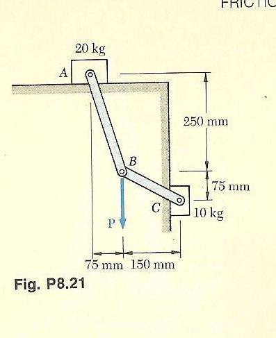

They ask for the smallest force P to apply if neither block is to slip. Coeff. of friction given as 0.25.
The 20KG block is 196N; the 10KG block is 98.1N
[/B]
[/B]
If we start at the 10KG block:
Sum of forces x: N + cos26.6P – (cos55.33)(N of 20KG block)
Sum of forces y: -98.1 –sin26.6P + 0.25N + (sin55.3)(N of 20KG block)
So, P pushes the 10KG block away from the wall, and N pushes the block away from the wall; and therefore we need a corresponding force in the x direction to pull it back toward the wall. That force must come from the 20KG block, which is a function of its normal force (multiplied by mu, which we know).
How do we find that?
Well, for the bigger block:
Sum of forces in y: -196.2 + N - (sin55.3)(98.1)-cos16.7P
We have to add in the downward pull of the smaller block (as a function of its geometry) here, right?
Stuck here. Too many variables: Two values of N (one for each block) plus P.
Any help would be appreciated. Thank you :^)

  • Statics diagram Fig. P8.21: a 20 kg block at A on a horizontal ledge, a rod pinned at B with downward force P, and a 10 kg block at C on a vertical wall, with dimensions 250 mm, 75 mm, 75 mm and 150 mm.

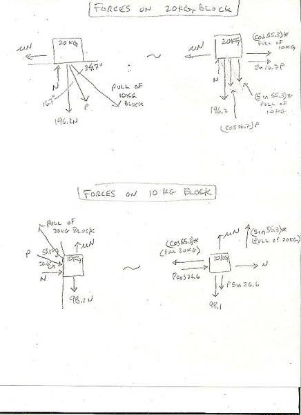

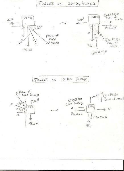

CWatters said:
You should start by drawing some FBD diagrams.
OK, here's my FBDs.
I wasn't sure how to handle the influence of the 10KG block on the 20KG block. From the point of view of the 20KG block, the 10KG block is pulling it down and to the right. But aren't both these forces also a function of the friction the smaller block feels, since it is dragging against the wall?

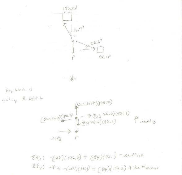

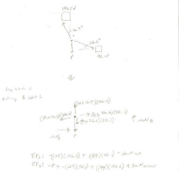

I think you will find it easier if you make THREE free body diagrams where the third one is point B.
OK, here's my FBD about point B.
From B's point of view, the 10KG is pulling it to the right and down slightly. The downward pull is offset by mu times its N.
From B's point of view, the 20KG block is pulling it up and to the left slightly. The leftward pull is offset by mu times its N.
And we have force P pulling straight down.
Is my logic correct?
